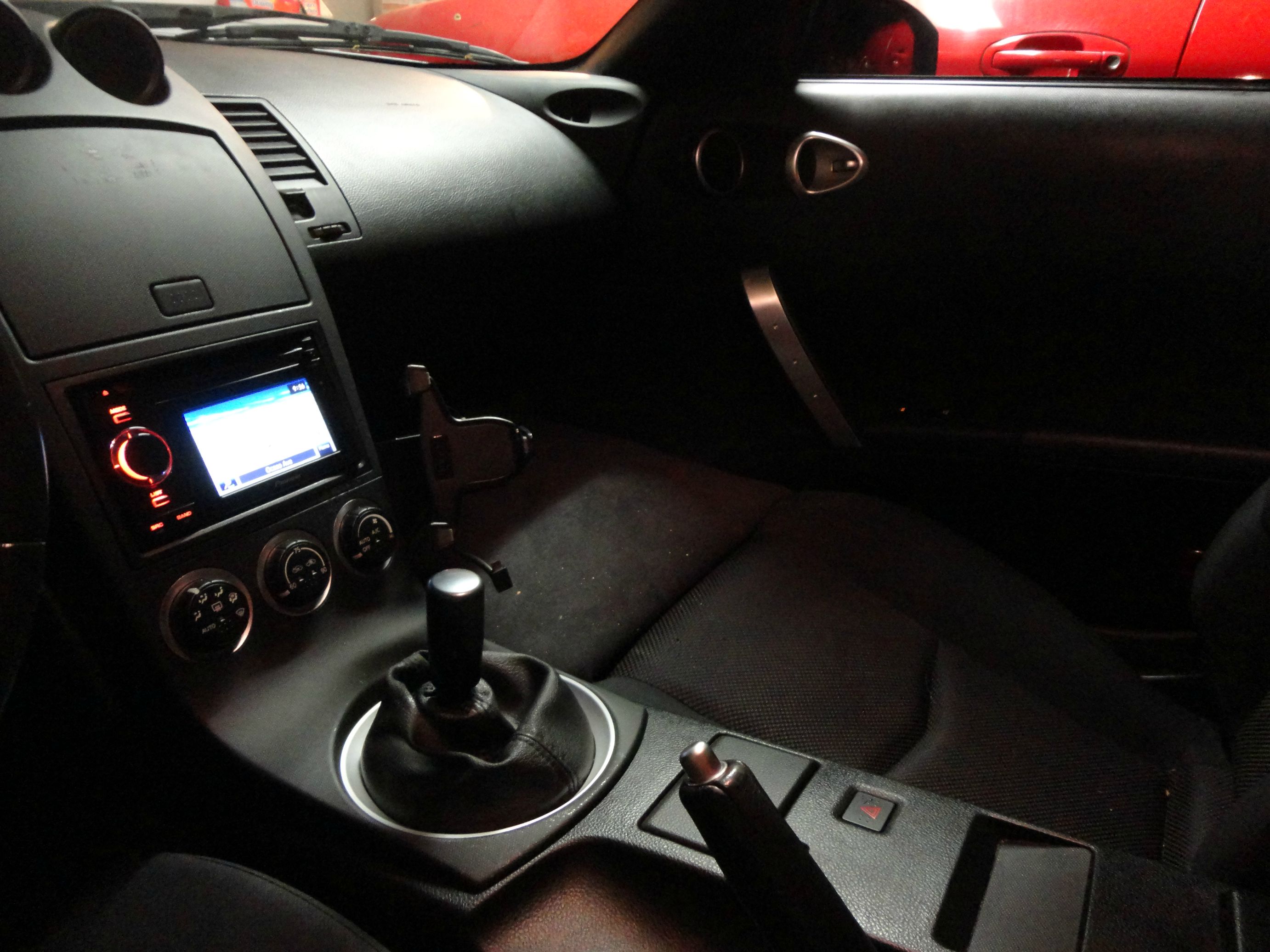

SOLUTION:
Anyone that wants to follow suit let me know I'll post dimensions. I'm semi handy I guess but anyone that has cut wood and can operate a reciprocating saw (or jig, handheld, etc.) can do it. What I lacked in a tool for extreme accuracy I made up for with sand paper and a sander.
Basic concept: As stated in my OP, I was looking to make the foot rest area a platform so that it is level with the seat's base. That way my dog can sprawl out and lay down flat. Before this platform, she could not lay down. She would have to remain sitting. Sitting is not a very comfortable position for dogs. It's not like for humans because dogs are constantly balancing on their front two legs in the sitting position. And yes, i drive EXTREMELY slow and cautious with my dog sitting in my passenger seat, like I'm carrying a baby in the car. Going to the dog park 10 minutes away I get honked at and people give me looks sometimes because I'm going so damn slow. Doesn't help that I have a manual either for the jerkiness but I try to smooth things out as much as possible.
Process: I just took simple measurements of the passenger foot rest area. Front is thinner (side to side) than the rear. Front meaning closer to the firewall. When I took the measurements, the passenger seat was slide all the way back as far as possible so depending on your preference you may have to adjust. I figured why not just put it all the way back, I'm not going to be putting anything BEHIND the seat.
If I remember correctly, measurement from side-to-side for the front was 17"-18" and the rear side-to-side is 21-22". It is 26" long from front-to-back. I used 5/8" plywood because that's all I had in my possession but I probably would have gone with 3/8" so it's not as heavy. Also used 2x4s for the legs.
Basic platform with 4 legs, like a table. Front legs and rear legs are NOT equal lengths due to the bumps in the passenger floor. If I remember correctly, rear 2x4 legs are 8 or 9" high. Front is 6" I believe. Used wood screws to fasten together.
Make sure you sand everything down so it's splinter free, wipe it down and then try a test fit in the car. Adjust the legs (before screwing them in) and then using a pen just mark where they would go. Remove, drill a pilot hole, screw it together. It's done!
Next, run to the fabric store such as Michael's. I bought one that similarly matched the cloth in my car. Would have looked kind of funny if it was vinyl or leather IMO. Bought tacky glue and a 12oz bag of Polyester fill.
Cut the fabric (make sure you have enough to wrap around and have a few inches left over to glue down. Glue 2 perpendicular sides. Then start stuffing with fill. Spread it out, no need to make it super fluffy, just evenly distributed. Glue the last 2 sides and seal it up.
Leave it in the hot sun for a day or two for the glue to dry up.
DO NOT try to screw screws to fasten the fabric to the wood. I tried this and what happened was the screw just tangled up the fabric and twisted it all up. The fabric is really tough. If you must, you need to drill a hole first with a small bit and then use a nail but the glue should be enough.
Making the legs
The platform (make sure you round the edges unless you want your Z's carpet ripped up. Sand everything smooth.
Basic idea, before screwing. needed to cut down the front legs once I tried it in the car
Everything screwed together, time for upholstery
Another view of it assembled
After upholstery, glue still wet and running. Left it outside in 100F weather for a day.

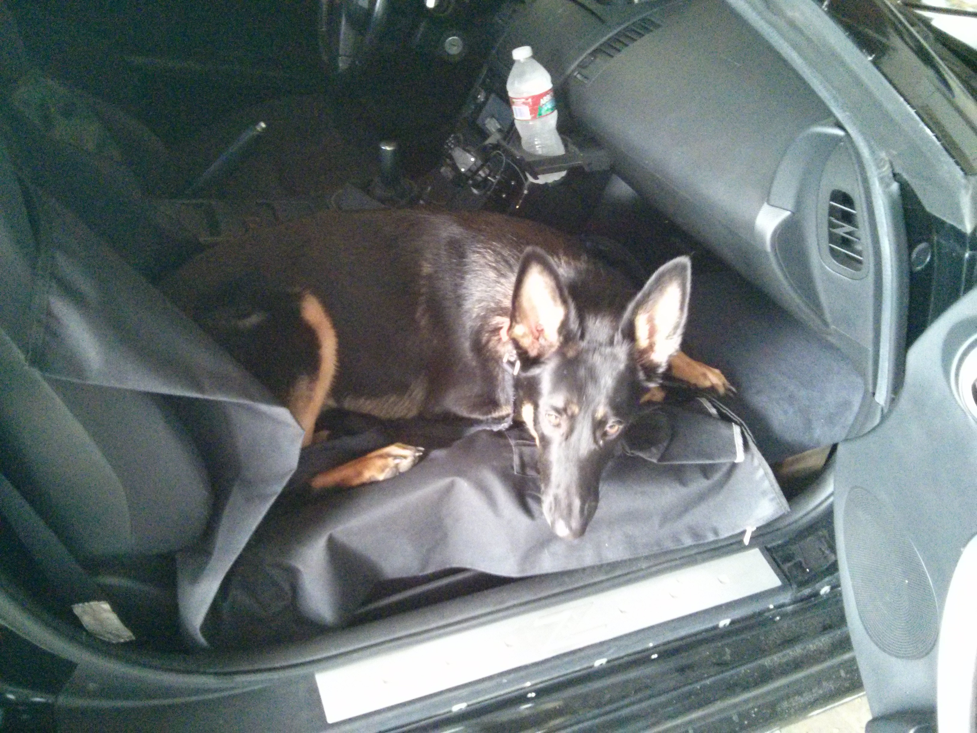

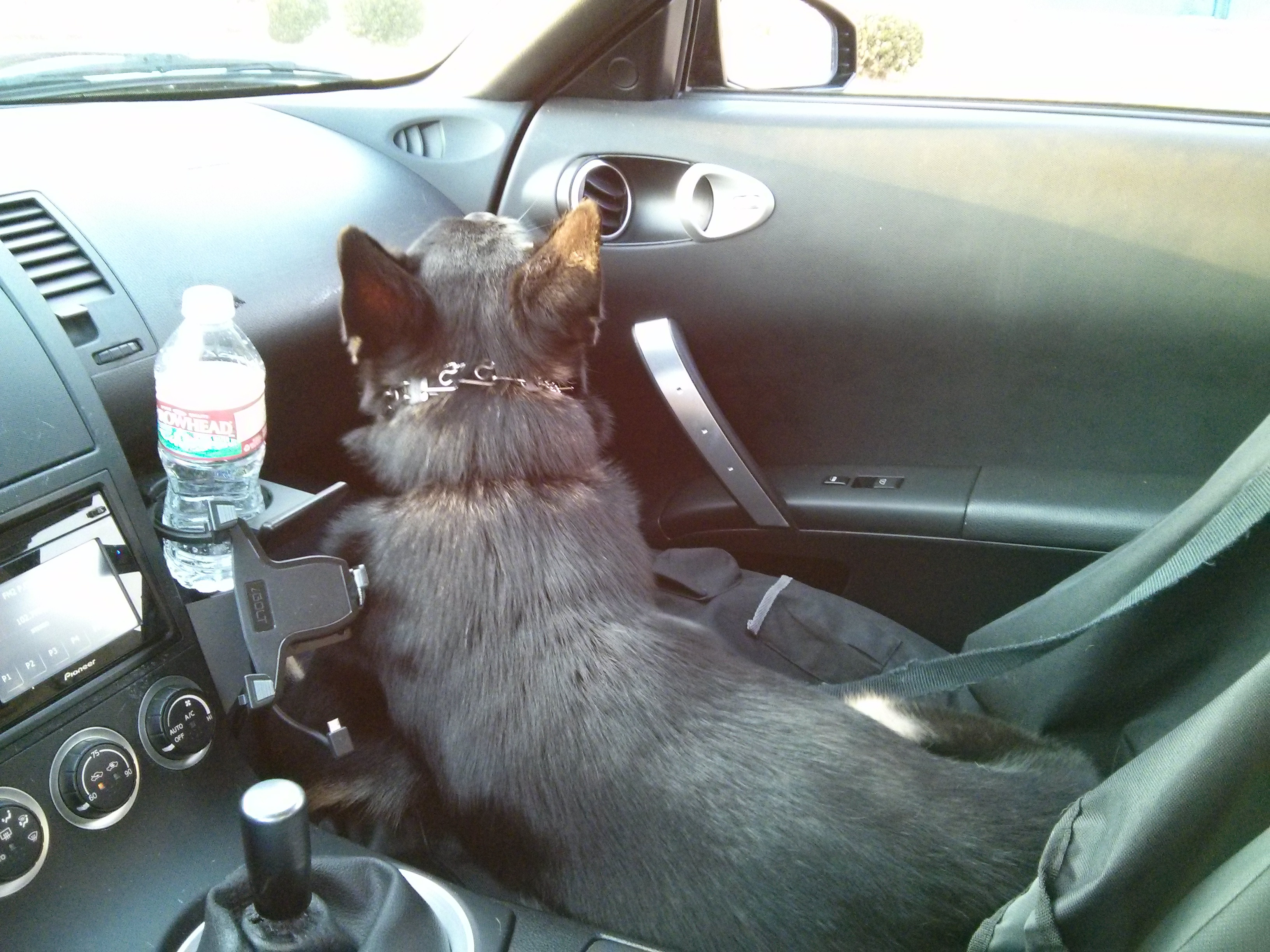

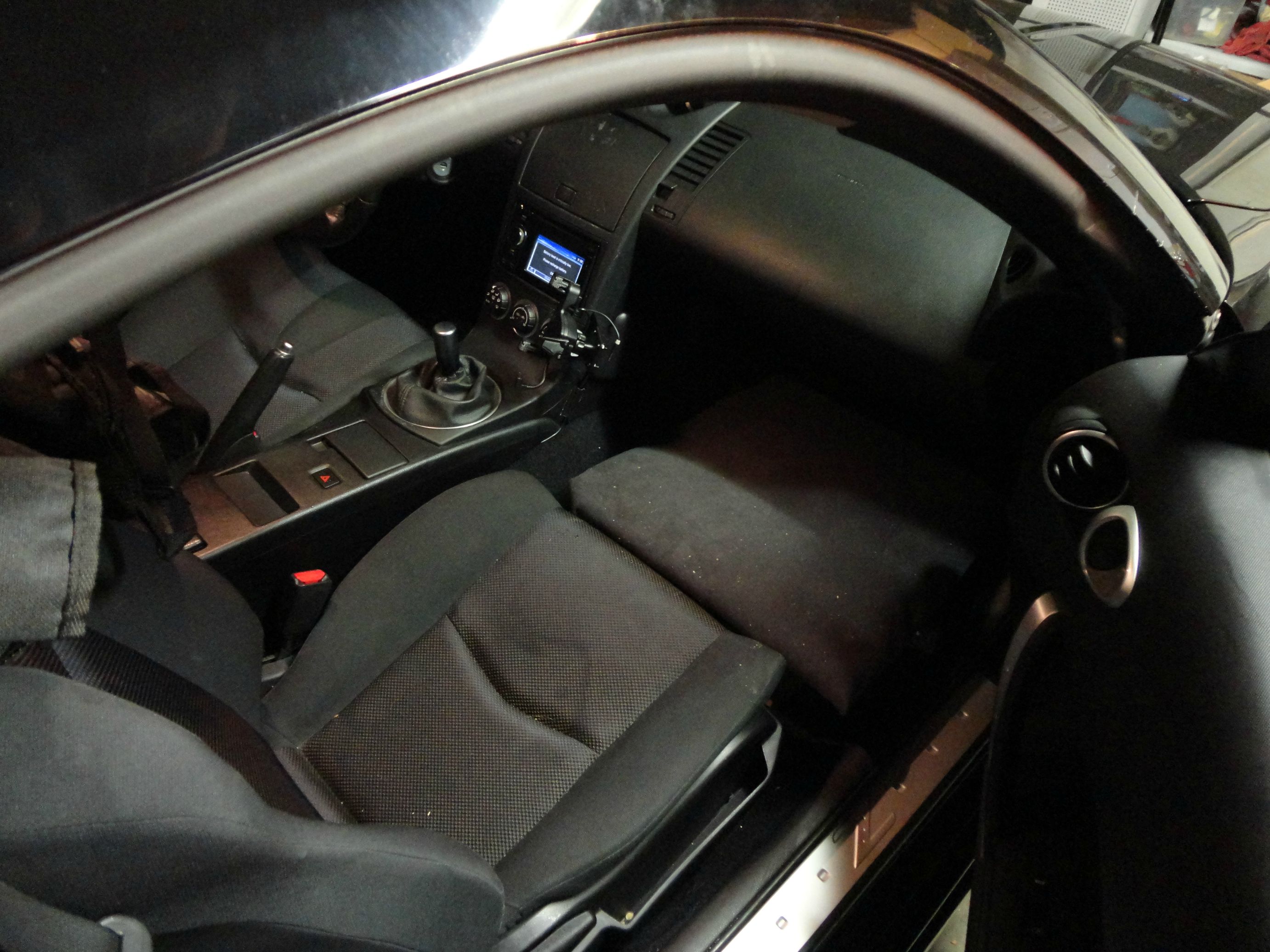

End result:
My dog testing it out:
On the way to the dog park:
For those interested, I use a dog Hammock seat cover like this one
It's just folded in half, wrapped around the headrest pins. That way I get ZERO dog hair, dirty and grime. Don't want her ruining the interior. Bought it at Marshalls for $12 or so.
fits in the hatch and easily removed! overall happy with it.
