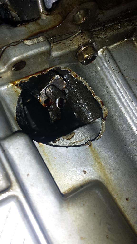

Ask and you shall receive. Sorry for the angle on a couple, but here's the window and the guts that fell out. I am loading the GoPro video right now. Kind of a great tragedy story so far...

Sorry to hear about your VQ, looking at those pics it was clearly some type of rod or bearing failure. Regarding what you were told, hard right hand turns are not the Z's nemesis. After racing the Z in SCCA and NASA competition for many years, I've never had a PCV related engine problem on any track in the country.
That's good to hear actually. After I was told PCV, it made me hesitant to consider reviving her from the dead. It was just strange that it was 5 quarts out, 5 quarts in and no noise concerns before going out there.

daaaaaaaammmmmmnn.
Looks like a bullet hole.

That looks just like the head of an intake(?) valve. I'd say that's what broke first, followed by the piston and connecting rod.
