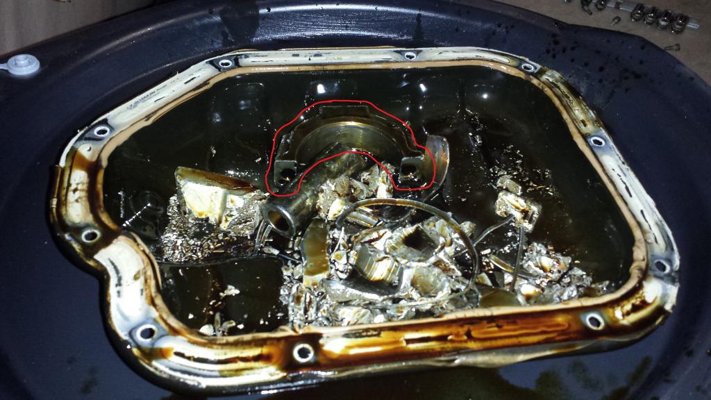

Update: Got the old motor out and "new" motor in. Headed out to TWS in a couple weeks and hopefully don't have the same results. I'm in the process of tearing down the old engine to play mad scientist with the dead carcass, and last night I discovered the culprit of what happened last time. I was under the assumption that it may have been the result of oil deprivation, but when I dropped the oil pan out I found chewed up parts galore. Take a look at the picture of the oil pan and notice the part I circled in red. This is the lower end of the connecting rod. If you notice how sheer it is and relatively untouched, it leads me to the conclusion that the connecting rod bolts came out while running around the track. Otherwise, if it had been oil deprivation, the damage would have been more catastrophic. Once I break down the cylinders over the next week I'll get a better look at it all and confirm this is what happened.
I have to say if this is in fact the reason I had to perform a heart transplant then this is the first I've heard of it happening on the VQ35DE. My old engine was made in 09/2002, and the "new" engine was made in 10/2004. Does anyone know if the connecting rod bolts were addressed/modified by Nissan?

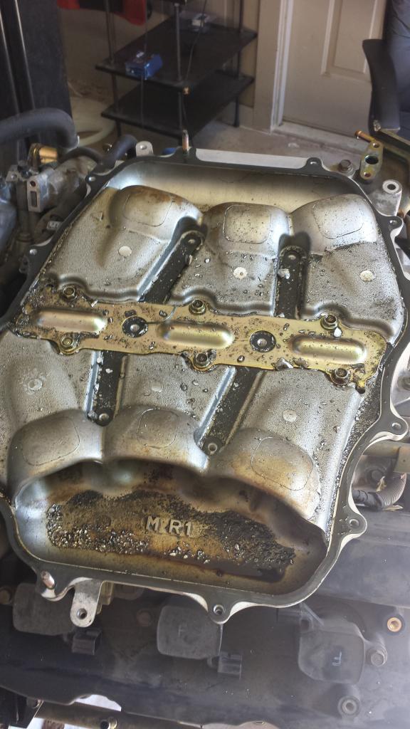

I thought this one was interesting. You can see all of the metal shrapnel that must have taken the path of least resistance (i.e. back up the intake manifold) upon detonation.

Here is the oil pan shot with the lower end of the connecting rod circled in red.

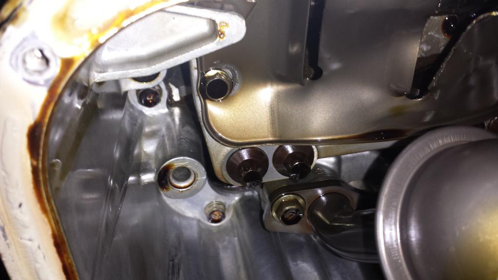

Looking up into the engine from where the oil pan used to be. You can see the gash on the right side of where parts spewed out.

Are the threads in that rod stripped out/damaged in anyway?

Originally Posted by BornSlippyZ
That is pretty crazy!
Good thought. I'll have to clean it out and check. If the threads are clean it's the cam shaft bolt. If it's stripped, then it's something else.

On your update: since this is your first teardown, I wouldn't jump to any conclusions. While it may have indeed been a connecting rod hardware failure, there's been no reports this has been a systemic problem. But looking at the bottom half of that rod sitting in the pan, I might hazard a guess that the rod itself may have had some stress and possibly failed. With the kind of mileage you had on that VQ, any missed shifts or overrevs could have stretched the rods slightly and created the potential for a catastrophic engine failure.
