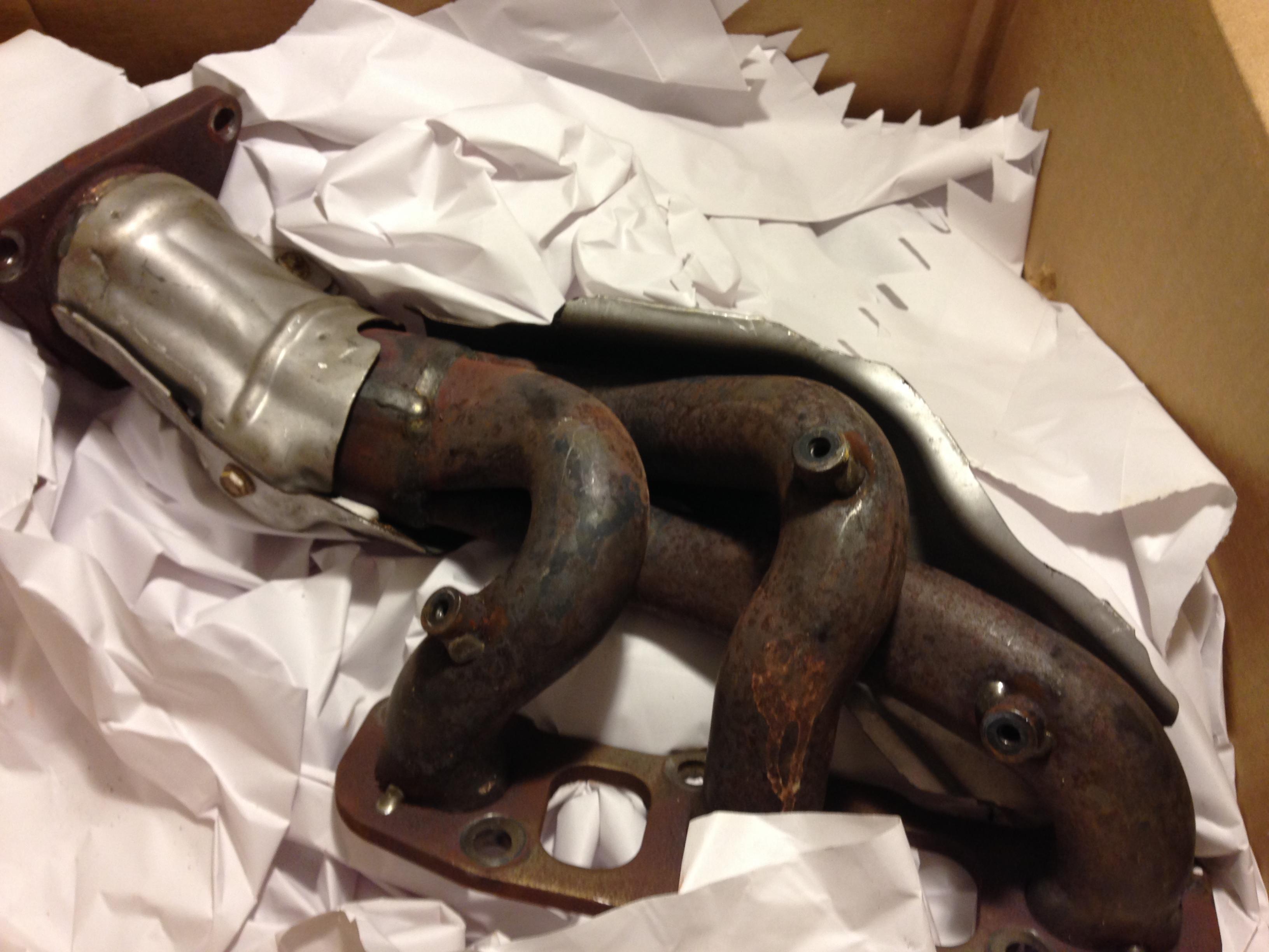

Hey all I am finally about to do an exhaust upgrade to my Z. It is a 2003 performance model. I recently ordered some 370z headers from Z1 motorsports and some berk test pipes to fit them. Z1 has a very professional packaging and I ordered the headers without the heat shields (I will be trying out some 08 heat shields to see if they fit).

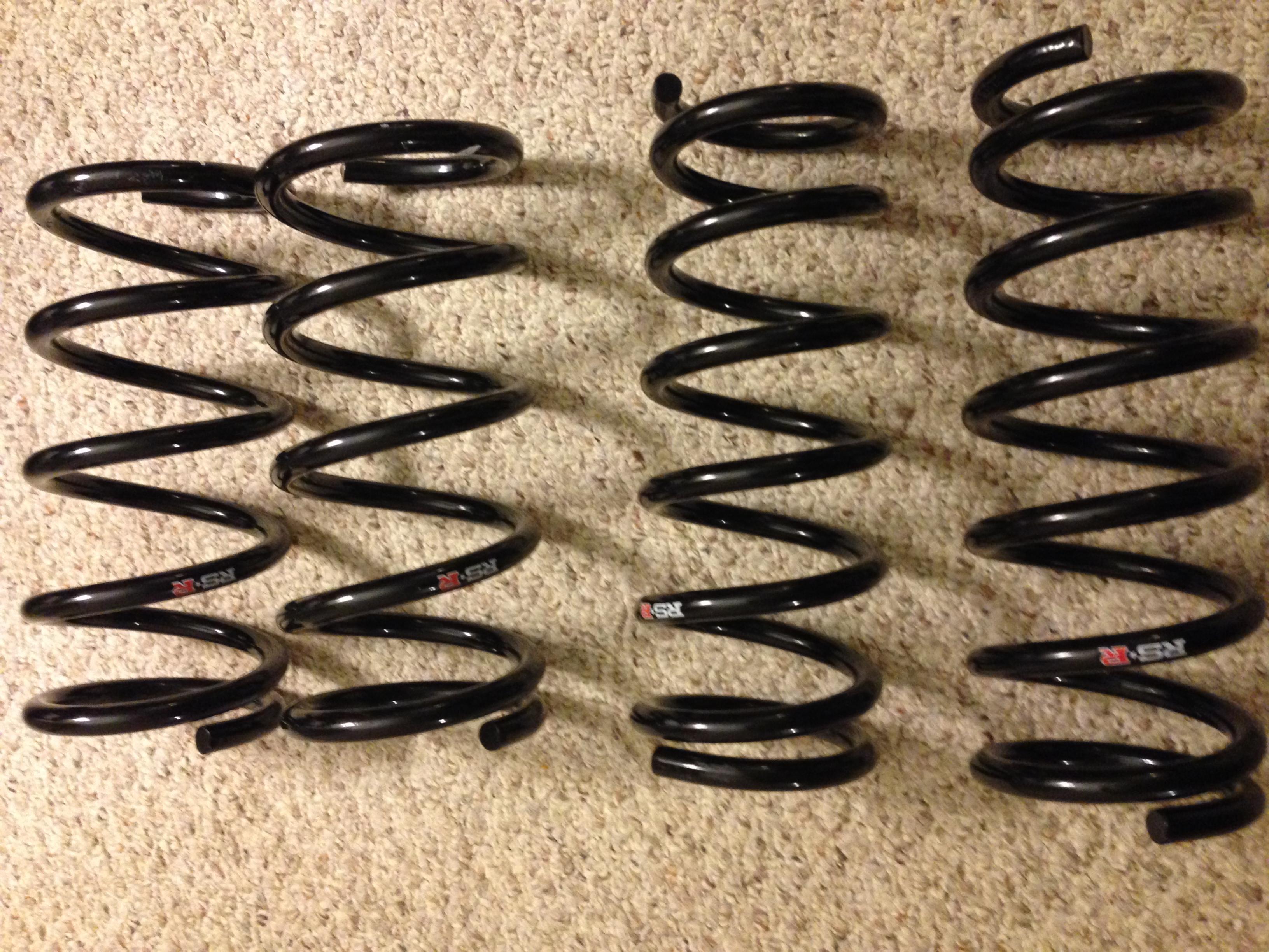

Next I almost forgot to mention I ordered some RS-R lowering springs. I have 2008 suspension that I got from one of our members and the spring rates on the RS-R's looked to be closest to matching the stock spring rates while adding stiffness and a bit of a drop. I combined that with some hotchkis sway bars and it made the car feel way better in the corners. I am however still getting used to the drop making a low car even lower...the speedbumps at my office center don't like me lol

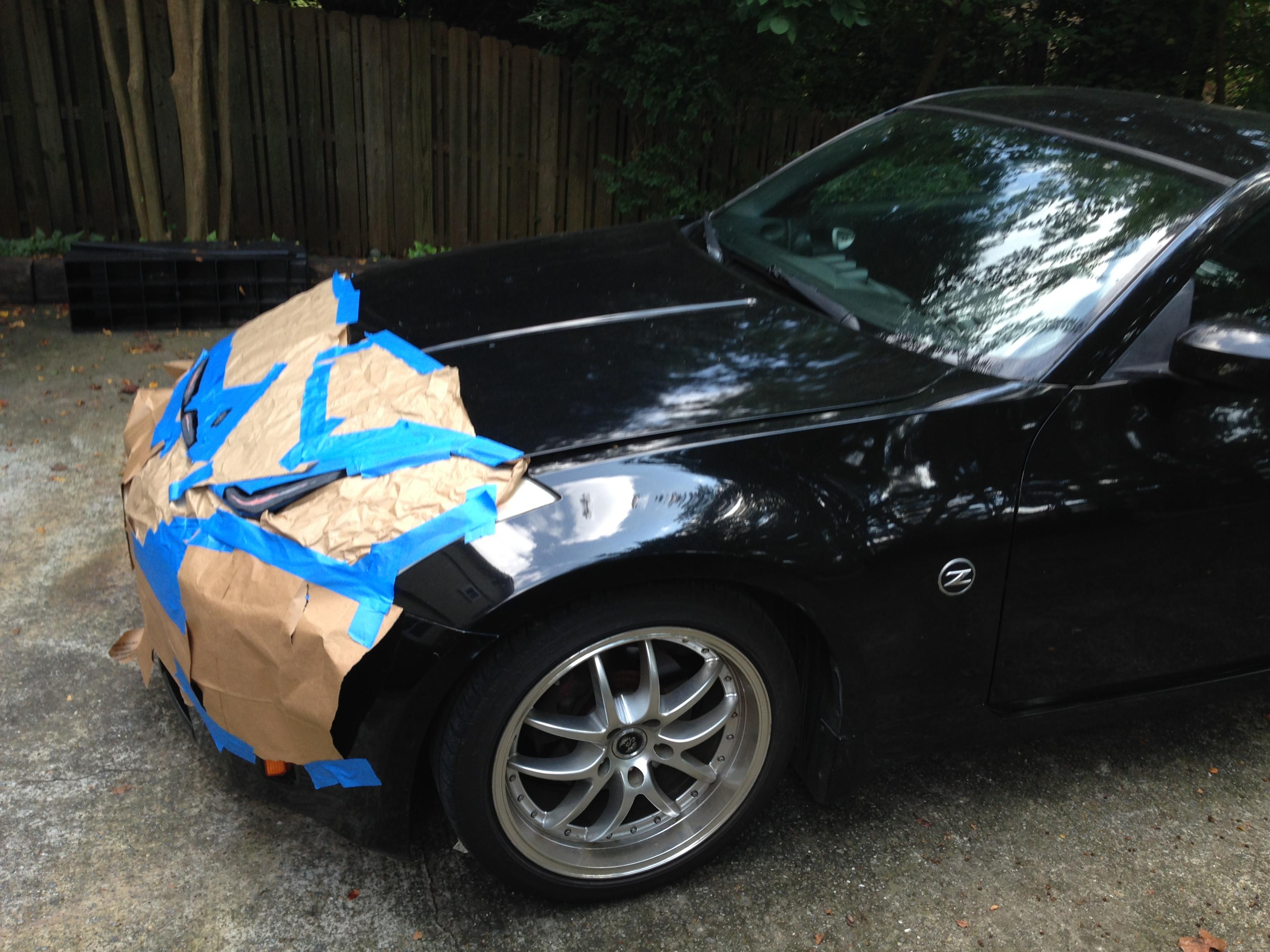

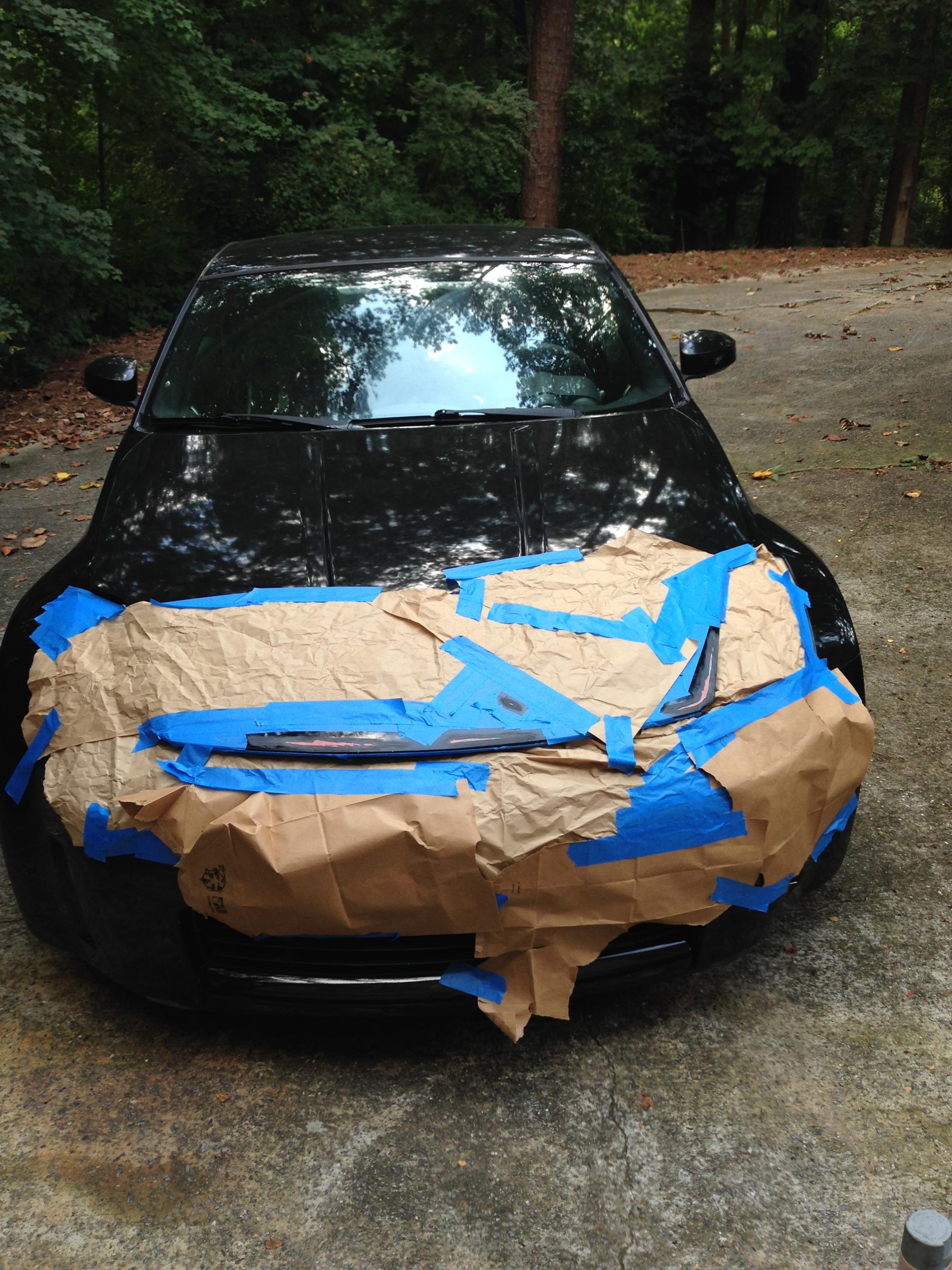

Along with this my hood was cracking 4 years after a repair job and I can't exactly go back to the body shop so I tried painting it myself...yeah I know. It didn't turn out great as I still need to cut and polish the area I resprayed and if that fails I figure I will just find a nice vinyl wrap (maybe some carbon fiber since the stock hood practically weighs the same
). The only other hoods I am interested in are the stock 07-08. Back to the painting though. Painting your own hood for spot repair is NOT recommended unless your on a tight budget. I didn't get the areas I was trying to fix sanded down well enough and you can see them showing through. I added in some pictures of the prep work for anyone interested. I also ended up buying a headlight off ebay (stock oem) and replaced my foggy lense with a nice clear one after realizing that I have xenon lights and the ones I ordered were the regular ones
