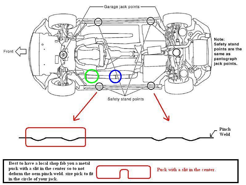

I would be pissed personally. From your pictures it looks like they lifted from the middle of the car (blue circle) when they should have been lifting from the green circle. I would also go over your floor boards; here's a disturbing read for you:
https://my350z.com/forum/2003-2009-n...up-a-350z.html
Looks like what happened to me. You can even see the impressions from the floor jack. Luckily I checked and it didn't go through the floor board. I am going to go double check after reading that, though.
