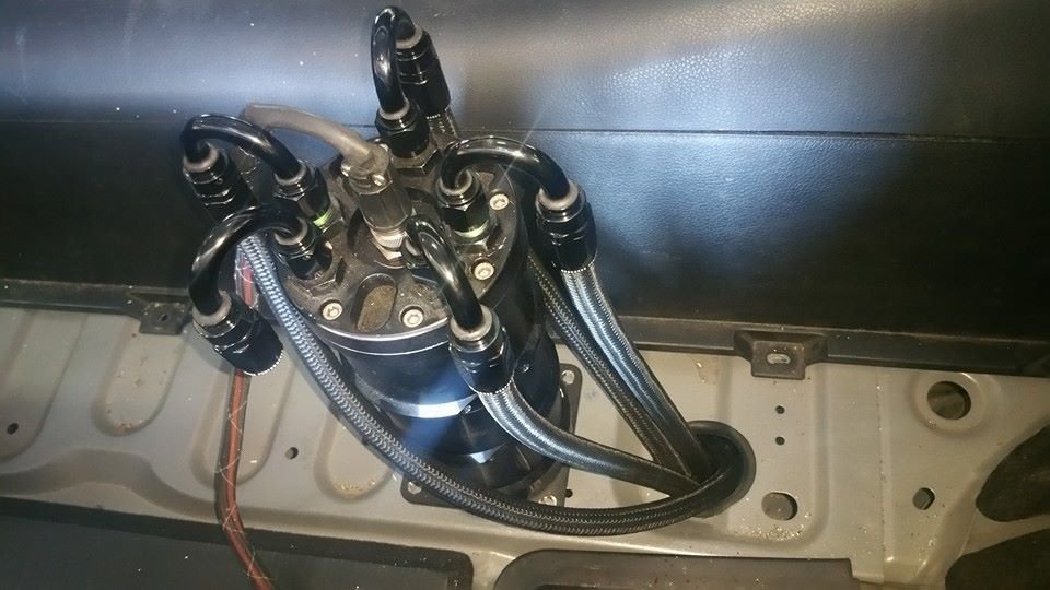

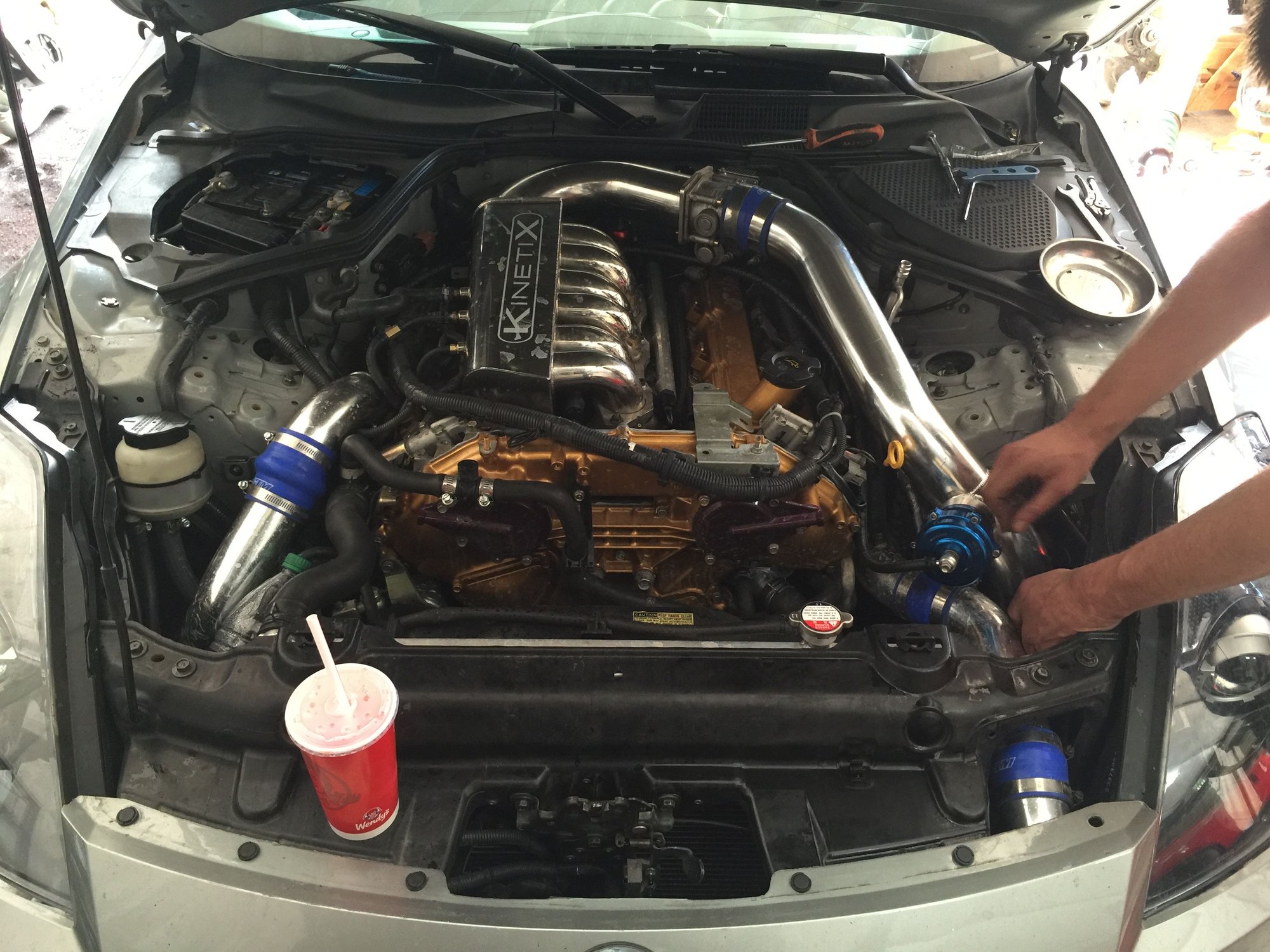

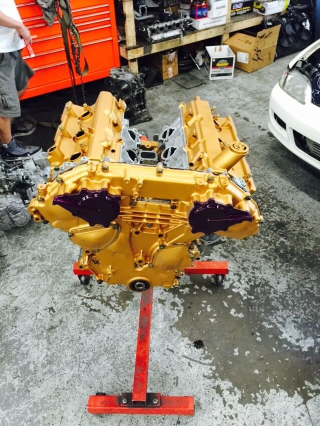

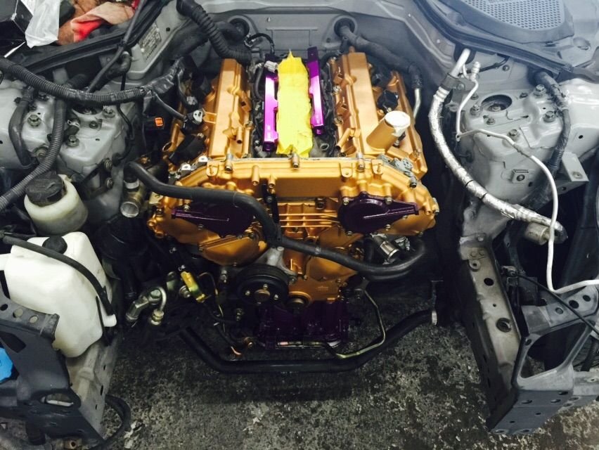

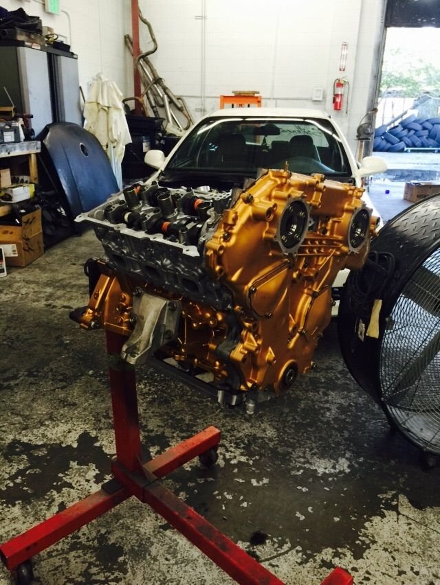

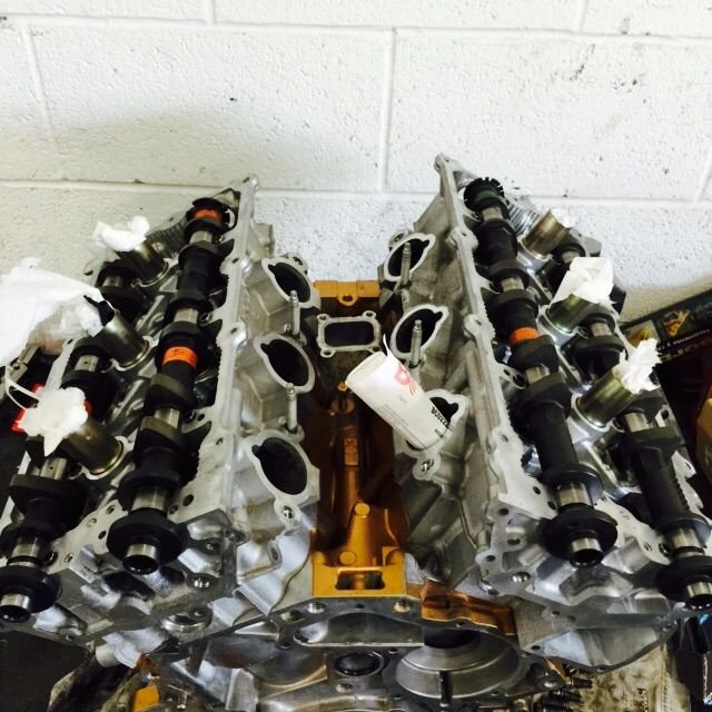

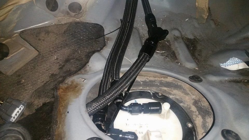

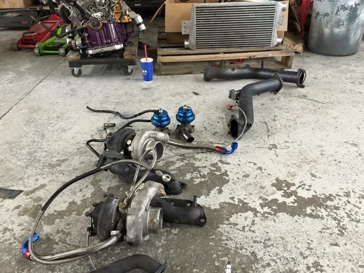

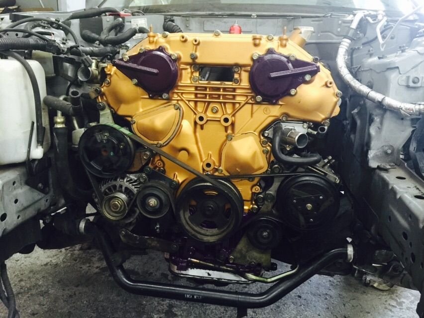

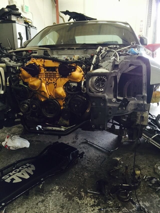

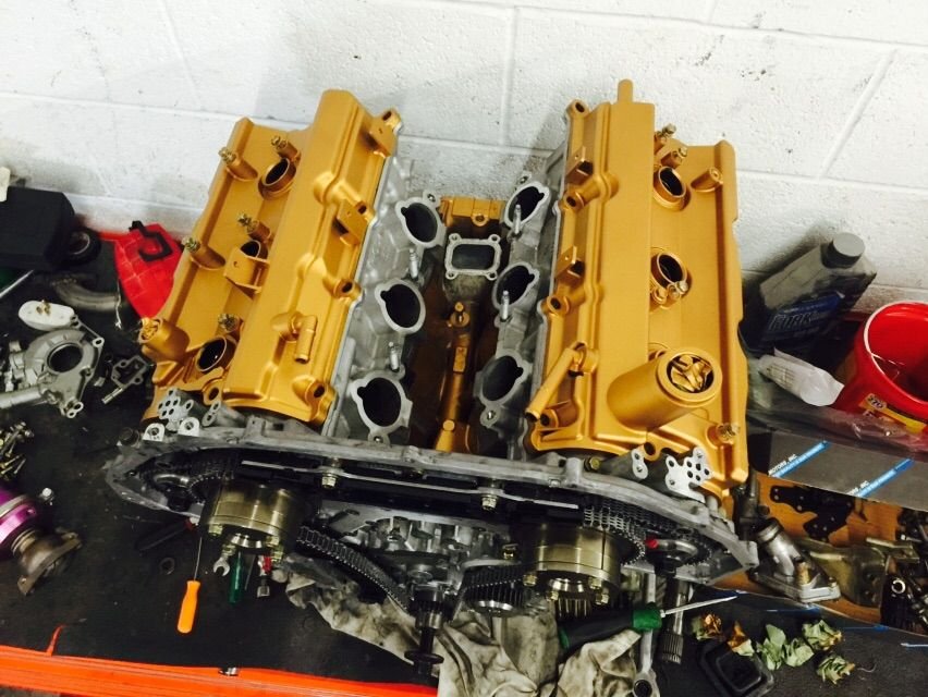

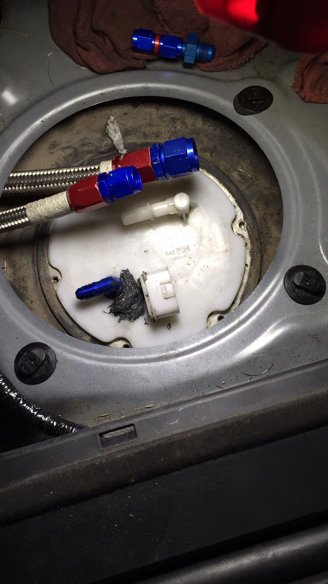

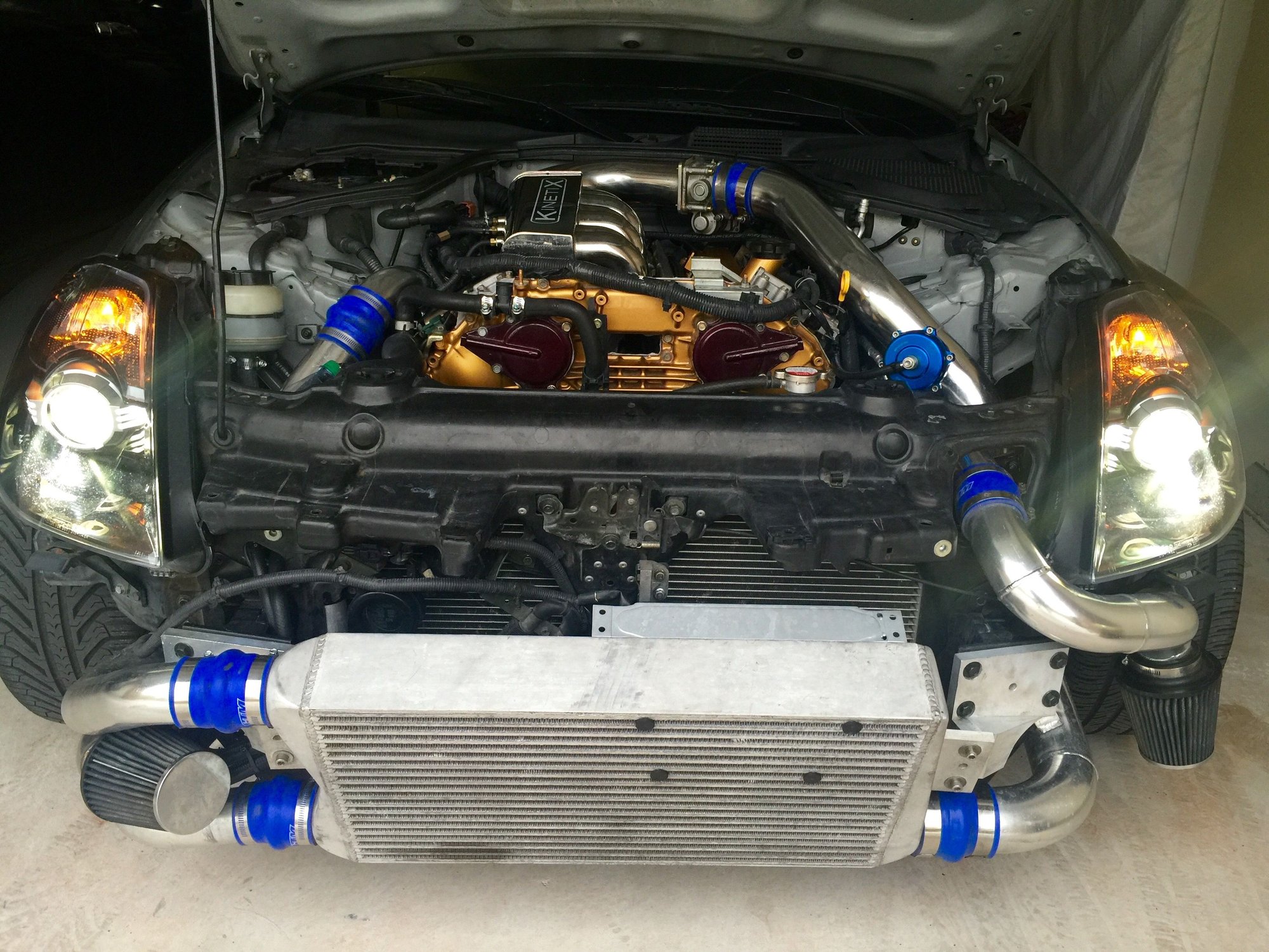

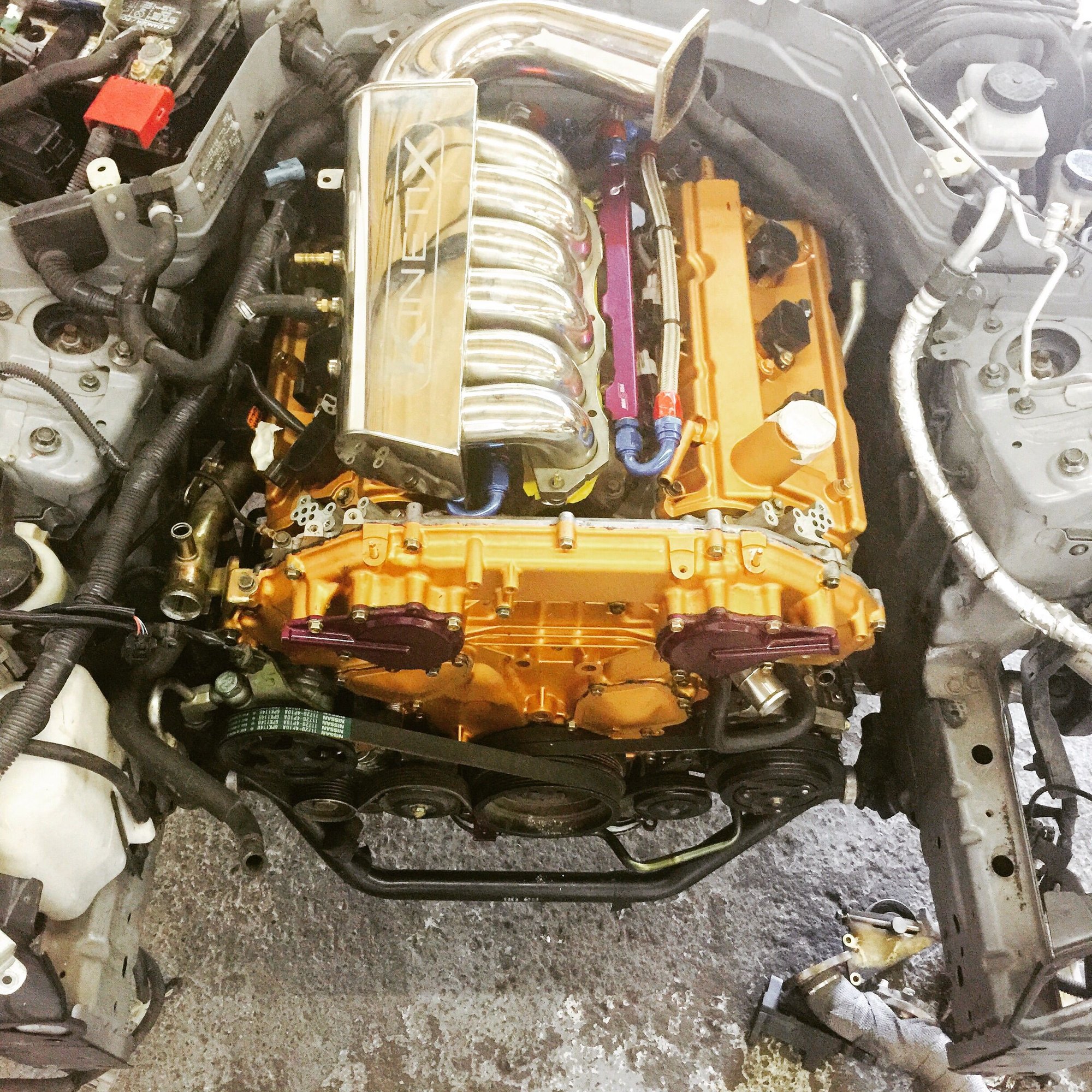

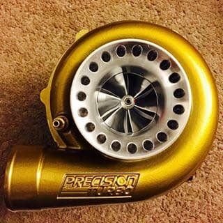

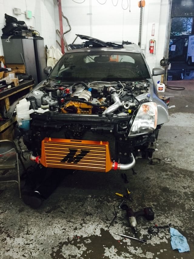

It was single turbo but I sold it and went twin turbo, made 630whp and 620torque but one of the turbos was damage causing me not to be able to get over 21psi, next day turbo seized up, pulled engine back out and they are both getting rebuilt as we speak and upgrading compressor wheel to 62mm, were shooting for 750whp
Block
Sleeved Vq block
Billet main girdle
Acl race main/rod bearings
Oil pan spacer
Eagle Rods
Cp piston
Arp l19 heads and main studs
cosworth head gaskets
Heads
5 angle valve job
Brian crower springs and retainers
Brian crower 272 cams
6266 precision turbo
Full fuel system -8 feed /-6 return
E85
255 Walbro and 450walbro fuel pump
Kinitex intake
Up rev Osiris tune
I'm missing more
Motor is built for 1000whp
I'm shooting for just 700whp
V8killas is complete... Vq35de kinitex Ssv intake
