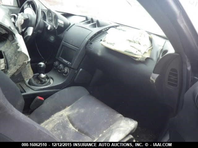

I bought the car as a wreck with ~100k miles on it. Its a 2005 Enthusiast with a manual transmission. It had moderate front end damage and light rear end damage. The damage consisted of broken core support, fans, radiator, AC condenser, drivers headlight, bumper cover, bumper impact bar and absorber, airbags, rear bumper cover, rear impact bar and absorber. The body damage was minimal with only a dented quarter panel and hood (both fixable) and a couple chips on the drivers fender. Here is the car as it sat when I bought it.
