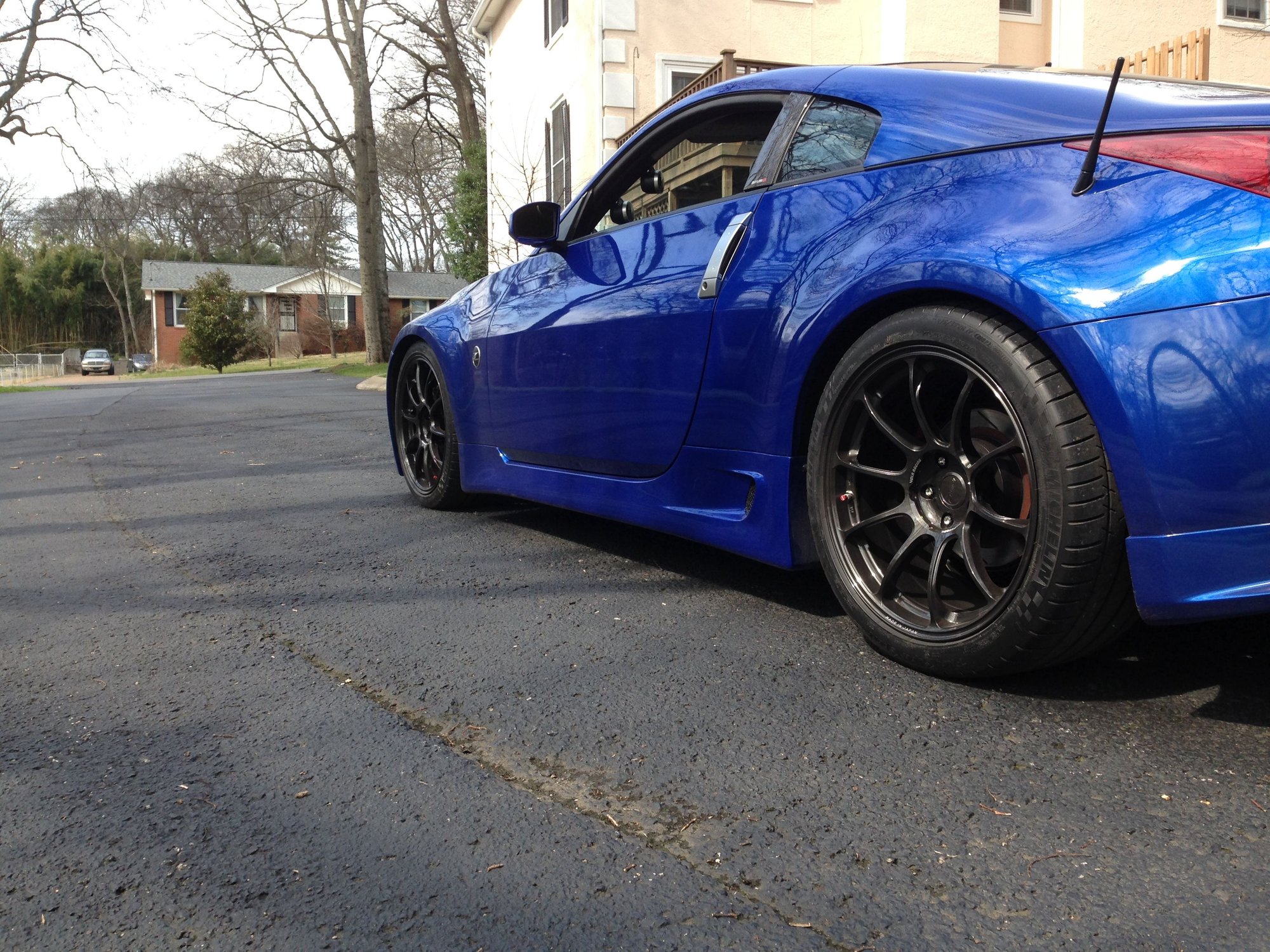

I just did 20mmF, 25mmR and it flushed everything up nicely. Here are a couple pics for reference.

Originally Posted by n0smoke
+1 on exact same size as a rear AE wheel. (Touring v2). (I have these all around)
Dayum, buddy. Looking great!

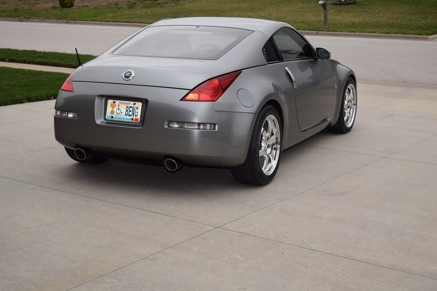

I've been running 25 mm spacers front and rear for about 8 years and never had a problem. The wheels fit pretty flush. I've had three or four sets of wheels during that time and the spacers worked perfectly with each of them.
