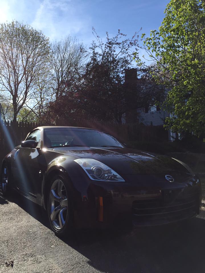

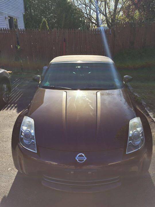

Here are a few pics
Attached Thumbnails New owner of 2006 350z Roadster GT-350z-start-1.jpg   New owner of 2006 350z Roadster GT-350z-start.jpg   New owner of 2006 350z Roadster GT-350z-start2.jpg
