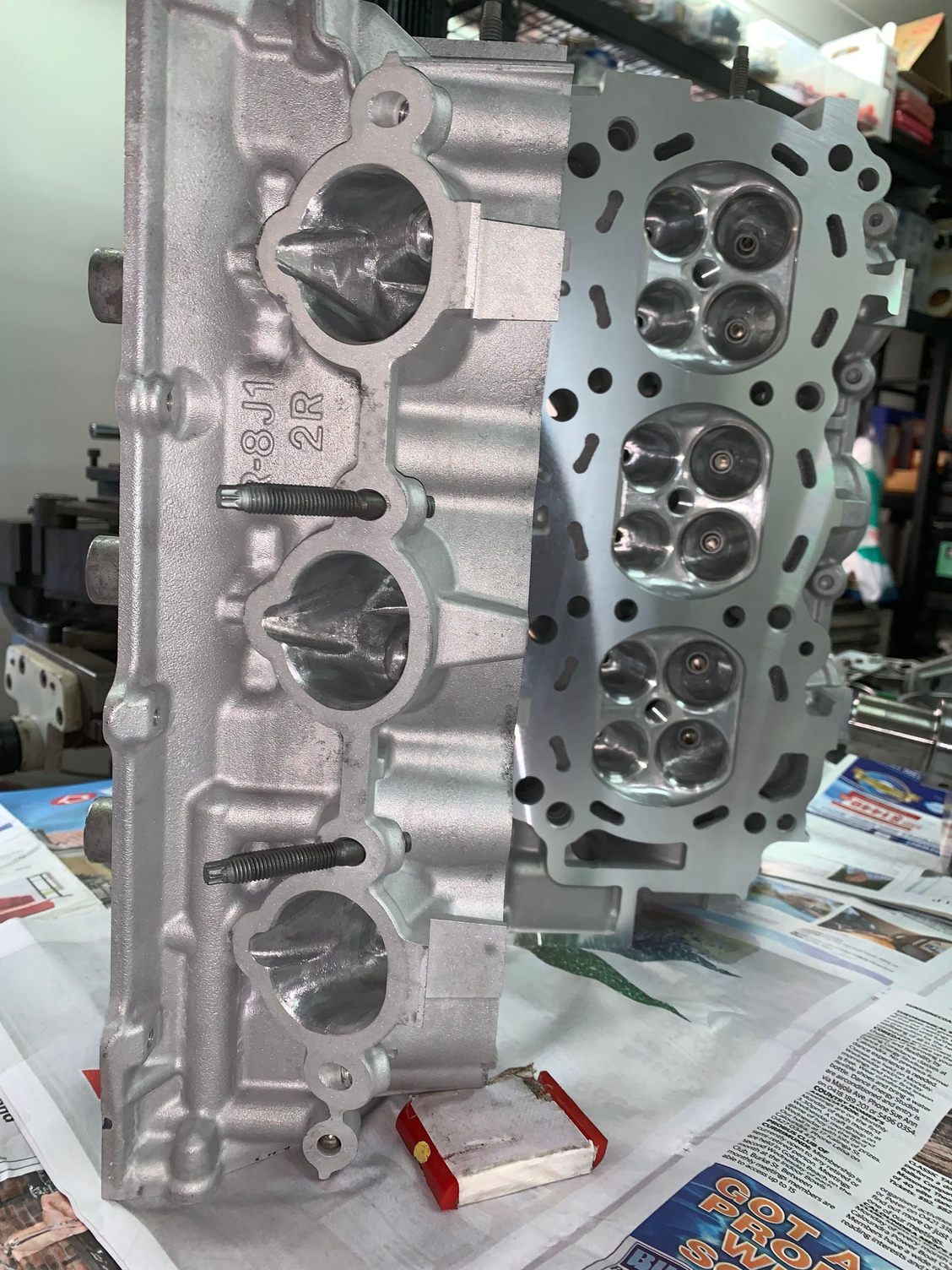

Hi, so after much drama this build is back on the rails.
You can follow on Instagram here: https://www.instagram.com/luthienz/
RP sent the motor out to be rebuilt in about May 2019. But the quote came back at a staggering $24,000 Australian Dollars. My total budget for the build was $41,000. I had already spent $24,000 in parts.
So I cancelled the project and asked them to scrap the car. I've had my Z for 13 years. I was devastated, but simply had no other options.
After about 4 months they came back to me and asked me to give a guy names Ron a call. He's a retired engine builder in Queensland who builds rally motors.
We had a quick chat, and I decided to to send the motor to him to see what he could do. He clearly didn't need the work, but was interested in seeing if he could have a crack.
We had another chat after he looked at the engine. He was happy I bought good parts (Jim Wolf, Jenvey, Direct) and was interested in the challenge of building a VQ.
He estimated $14,000, but was clear that it could be a bit more or less depending on what he found when he stripped it. They are challenging engines to build well.
I signed up. Yes, it's still a fair bit of money. But I liked what Ron pitched. He understood right away why I didn't want Turbos. With an NA engine, its his skill that will get me power.
The engine was dissembled a few months ago. The Cylinder Heads were sent to be ported and polished.
Ron finished his backlog of Rally engines.
And how he's assembling my 8000 rpm VQ!
Yes, I know there are simpler routes I could have taken, but this is my car and my vision. I'm using quality parts and quality craftsmen.
It's been 2.5 years in a disassembled state. The A5 has kept me company. But I need that sports car feel back!
Budget has $3,000 left. I'm going to have to delay suspension, paint and bodywork until at least July 2021
