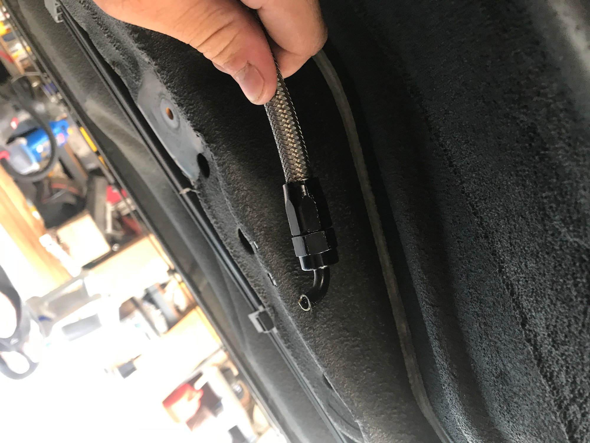

So decided to go head and made time to go home to see if I could track down the issue.
well... learned a lesson to not buy cheap an fittings, went to barely tighten the feed line and it completely snapped.
Im hoping this was the problem atleast, car will be down till parts come in and I can go home for Labor Day. Checked the scavenge pump lines and pump works great, sprayed oil freaking everywhere. Feed line is pretty new and wasn’t a problem there besides the snapped 90 degree.

that'll do it...
