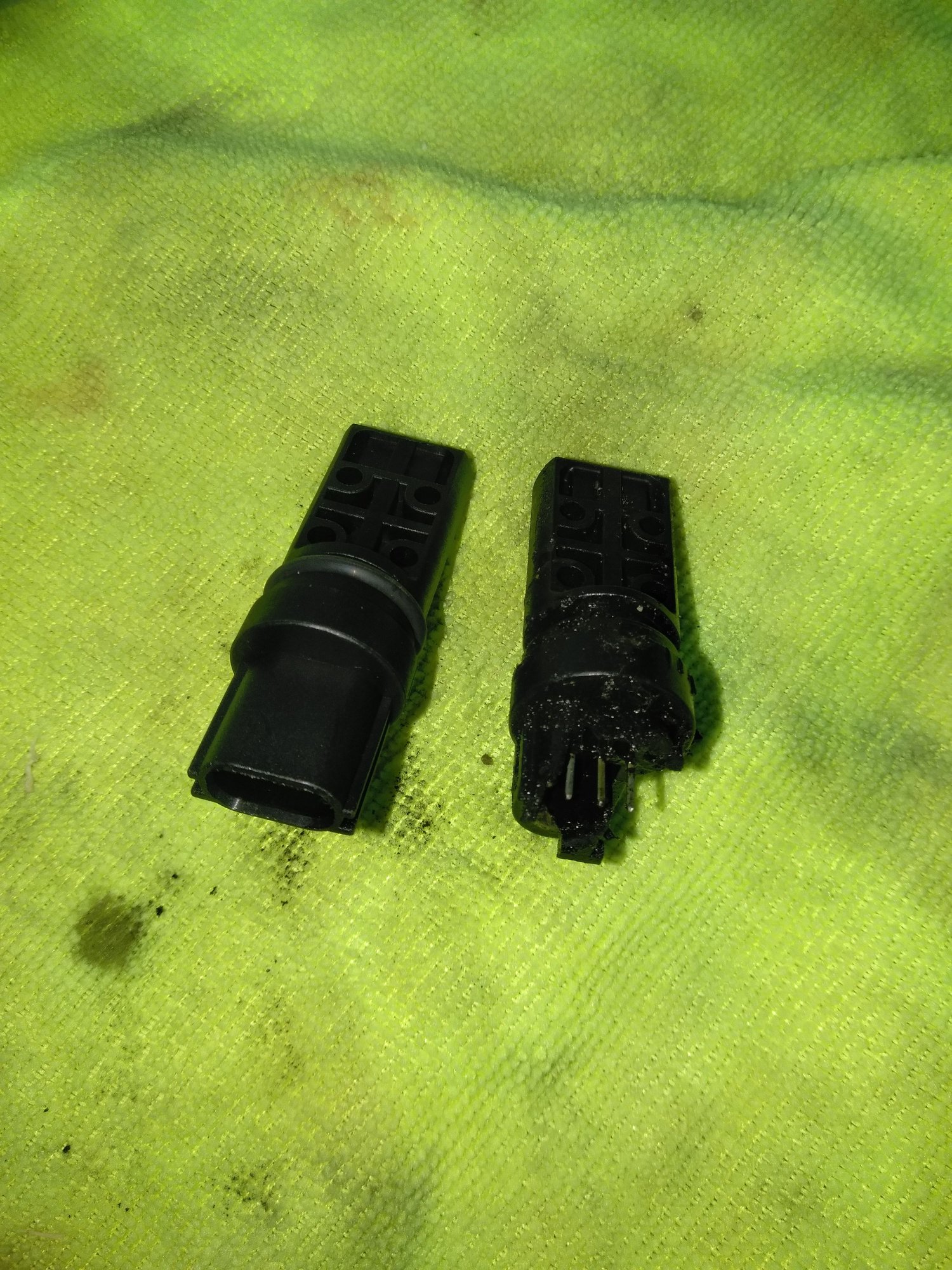

Well I found my issue.
The connector was perfect but dirty. It's amazing what people will ignore on cars
https://i.imgur.com/5sj6fEH.jpg

Hard diagnosis without having access to the car. Glad you found the problem.
