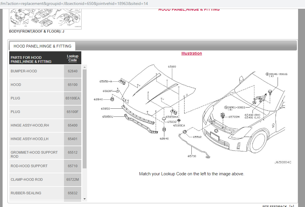

Originally Posted by Evenflow80
I don't have any rubber bumpers at all. The bottom of my hood is completely bare.
Shouldn't be. In addition to the hood bump stops, you should also have weather stripping seals at the front of the hood.

Post a pic of the underside of the hood
Old May 6, 2019 | 08:49 PM
mr. sparco's Avatar
mr. sparco
Posts: 7,090
Likes: 460
From: Sunny Beaches
Check the list and see if you have everything.

the seals won't provide any adjustment, thats all they do is seal from water coming in or prevent vibration. The "seals" towards the middle of the hood, sit on the strut bar across the center of the engine bay. The bumpers located towards the hood lip are your only hope of any adjustment, without messing with the hood brackets inside the quarter panels or where the hood attaches to the brackets at each corner of windshield.

OP was asking if it was dangerous, at higher speeds, seals in the front keeps the hood better seated and planted by directing air over. A vacuum/low pressure area at the frontal cavity, at the bumper cover and front of hood, is created as air goes over the top and drawn into the radiator. You want this area to not catch air hence the two seals at the very front of the hood. Water goes through the radiator easily and where it sits further back. The air that does pass through exits underneath. Its a balance of upper and lower air flow management with body panels and undershrouds to create Nissan's "0 lift" marketing slogan for the z when it first came out.
OP stated his hood was bare. I'd take it back to the shop, missing pieces and parts after a repair isn't a sign of quality work.
