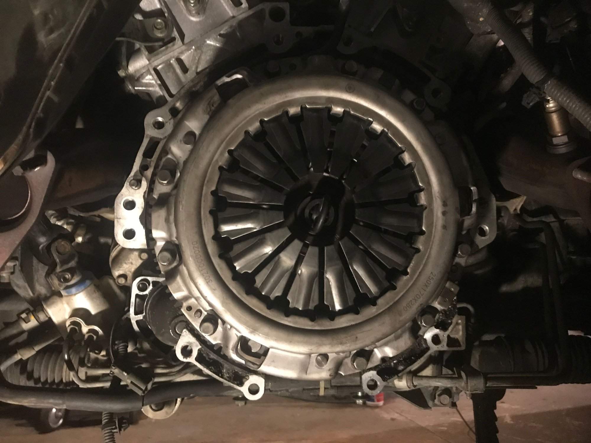

So, the POS OEM slave finally failed at 100k miles, and I replaced it reluctantly with a new OEM-replica slave cylinder that I had available in a pinch. Well, let’s say it made it TWO HUNDRED f’n miles before it blew again, during the second bleed while it was in the air (pedal never felt right). Today, I got my
ZSpeed CMAK Relocation Kit. Any thoughts or other experiences besides the ones already posted here regarding this system? Seems to be bulletproof... going back together tomorrow after I powder-coat the trans gunmetal (I know, I know...). Thoughts? 🤔
7/2:CSC failed. Old clutch out, trashed by brake fluid soaking it.
Friday 7/5: New CSC fitted.
Friday 7/5: New clutch in.
7/9: Brand new CSC dies.
7/11: Trans out for cleaning/powder-coat tomorrow.
7/11:ZSpeed CMAK arrives. Hoping for the best (a reliable clutch SC). #FAIL Nissan. BIG fail. (Although the second slave I used was an OEM replica, but regardless).

As expected, this system works AMAZING. Better than it ever was with the OEM slave! 💪
OEM trash removed.
ZSpeed’s HD conventional-style release bearing. Built like a tank, just like the rest of the system!
CMAK installed! Works great!
