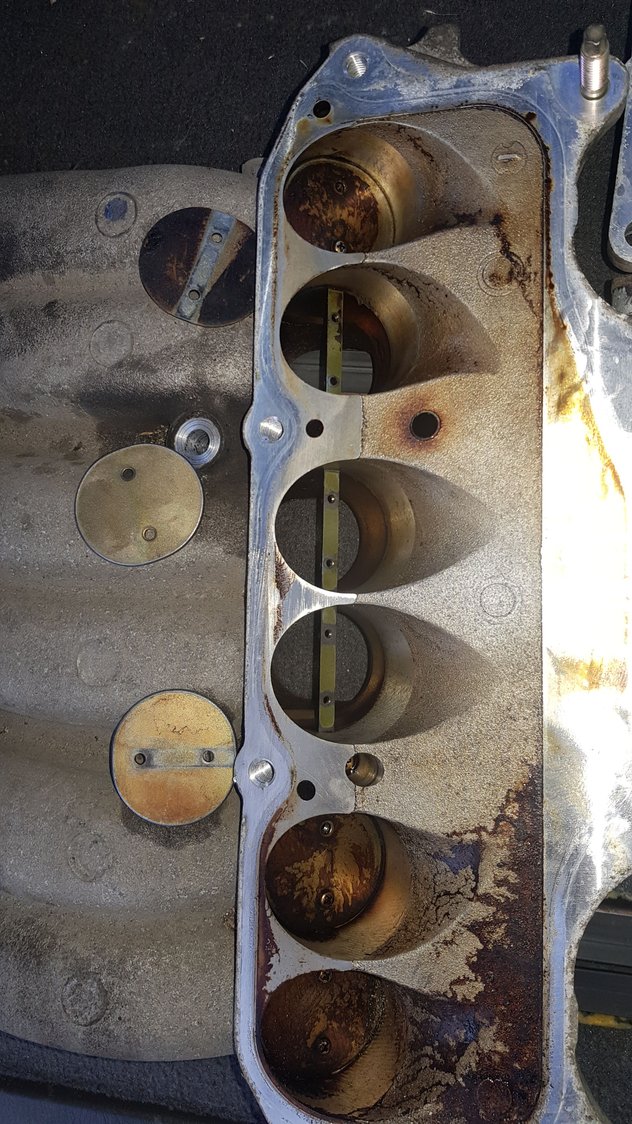

Old Aug 13, 2019 | 06:18 PM
tomuchofme's Avatar
tomuchofme
Joined: Aug 2019
Posts: 3
From: sunshine coast
are all your butterfly bolts still there? mine fell out and was in the cylinder smashing about the butterfly plate was sitting ontop of the valve. this is on a VQ35DE out of an elgrand but i think they have the same intake in the 350z>? correct me if im wrong..

Originally Posted by Dtsmmarah
I did, definitely louder on the driver side of the block
Sorry asked the same question the other guy did.
From my experience its well worth ripping the top off to look at the cams and rule that out.
Like i said mine was tiny screws in the cylinder. If it is big end you may be able to polish the crank and put a new shell in but i dont see that as the issue unless its had wrong oil or poor servicing mixed with thrashing
This intake is really specific to the Pathfinder or other VQ35DE chassis models. The 350Z intake is very different and doesn't suffer from the butterfly valve screw problem (common among that generation of pathfinders).
