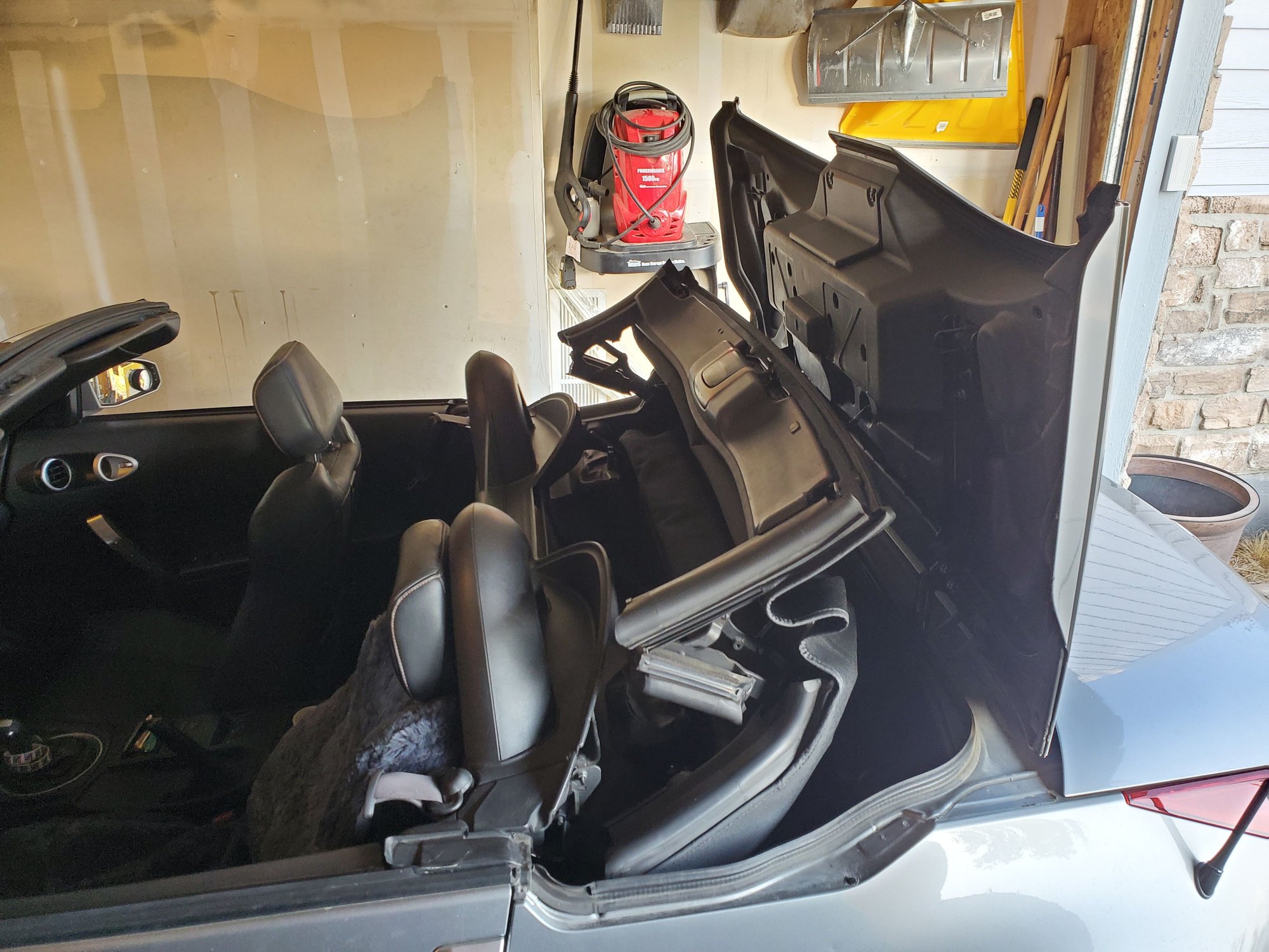

This is as far as it opens
This is how far it closes.

My new top only had the 2 replacement straps. No other were attacked to any other bars.
It's acting like the back cover won't move, whatever triggers it.

Ouch! I'm not an expert, but you need to find the switch that activates the tonneau cover to move. I suspect there are 2, one that signals when the front latch is fastened, one when the canvas is fully stowed. Have you pulled out the vinyl to check all connections? Unless someone knows right off, it will require some reading. Start here-
