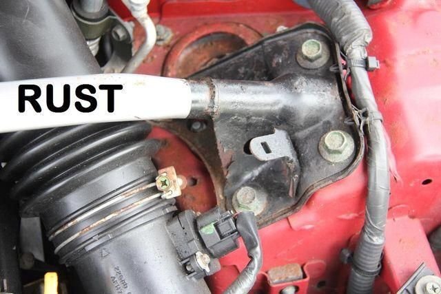

So I’m planning to buy a 2004 Nissan 350Z Touring, but there’re rusted parts on the car. My question is: Is it expensive to repair/change these parts?

Rust on the TOP of the strut tower? Whew, bottom must look spectacular!!
Honestly? There’s zero resale value and even if you keep it, it’s going to corrosively depreciate every minute you own it. But yer choice.

After re-reading and looking at pics closer on computer (instead of my phone which isn't good for people with bad close up vision)..... 5k miles?? That's it? The upper strut bar should be very easy to change - junkyard part for cheap too. But, I'd say look (or have someone look) very carefully at the extent of rust on the underside of the car. If it's just bolt on pieces that are rusty and no evidence of the rust getting into the frame rails or body panels then it might be an OK purchase but even still, $8k still seems high to me. But if you have someone look at the car that knows Zs and they say it's mechanically sound, maybe a lower offer to buy the car is worthwhile with only 5,000 miles.

Strut bar area actually doesn't look that bad. Sand, treat rusty with a converter, prime and paint. Under car looks a little rougher. I would concider changing that rear brace with an Ultra racing brace then just clean other things up as you get to them. I have a pic of the rear brace in my albums. A little time here and there and some paint/prep materials and won't cost you much to clean up.

The rust under the car isn't the issue, really, the W brace under the car rusts easily. But there seems to be some rust on the strut bar, strange.
