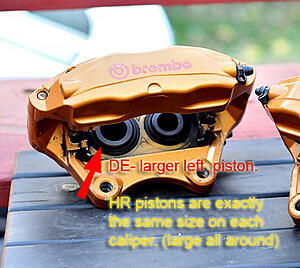

Rotor sizes should be the same, its the piston diameter that differs. I never took pictures but the 07-08 front calipers has slightly larger pistons. I know so because I have owned both DE and HR Brembos.
Not 100% sure on measurements, IIRC its been years since I had held the calipers in hand...
DE = 44 & 38mm
HR = 44 & 44mm

Old Oct 11, 2019 | 03:53 PM
mr. sparco's Avatar
mr. sparco
Posts: 7,090
Likes: 460
From: Sunny Beaches
Originally Posted by 350breeZy
Thanks for those measurements! Looks like I'll be uninstalling them and measuring the pistons on the rear then.
My mistake, I was only talking about the front calipers. I missed the part that you were doing a dual rear setup. I know that the front calipers are different by the piston diameter size variances. I suppose if the front has different calipers between the DE and HR, then the rear may have had updates as well, though not well documented.
