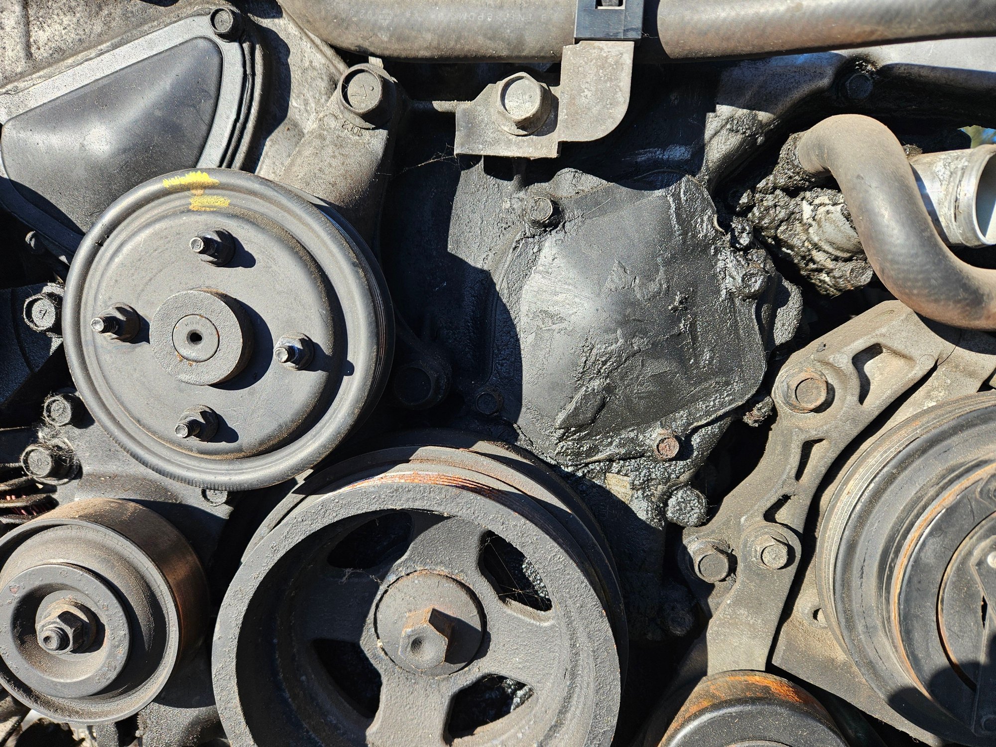

As I moved it into my shop garage this weekend, I was looking over signs of oil seepage/leaking, and I wanted to get your thoughts on what the likely sources are. I am seeing the valve covers as a possible source, but what else? Also, the donor G35 was an automatic, whereas my project '03 Z is a manual. I think I've read that the pilot bearing needs to be changed? Anything else? This thread looks to have a lot of helpful info. Doesn't look like there will be much I need to do other than swap the '03's flywheel and clutch to the new engine during installation.

I took a couple of pictures this morning of the engine.
