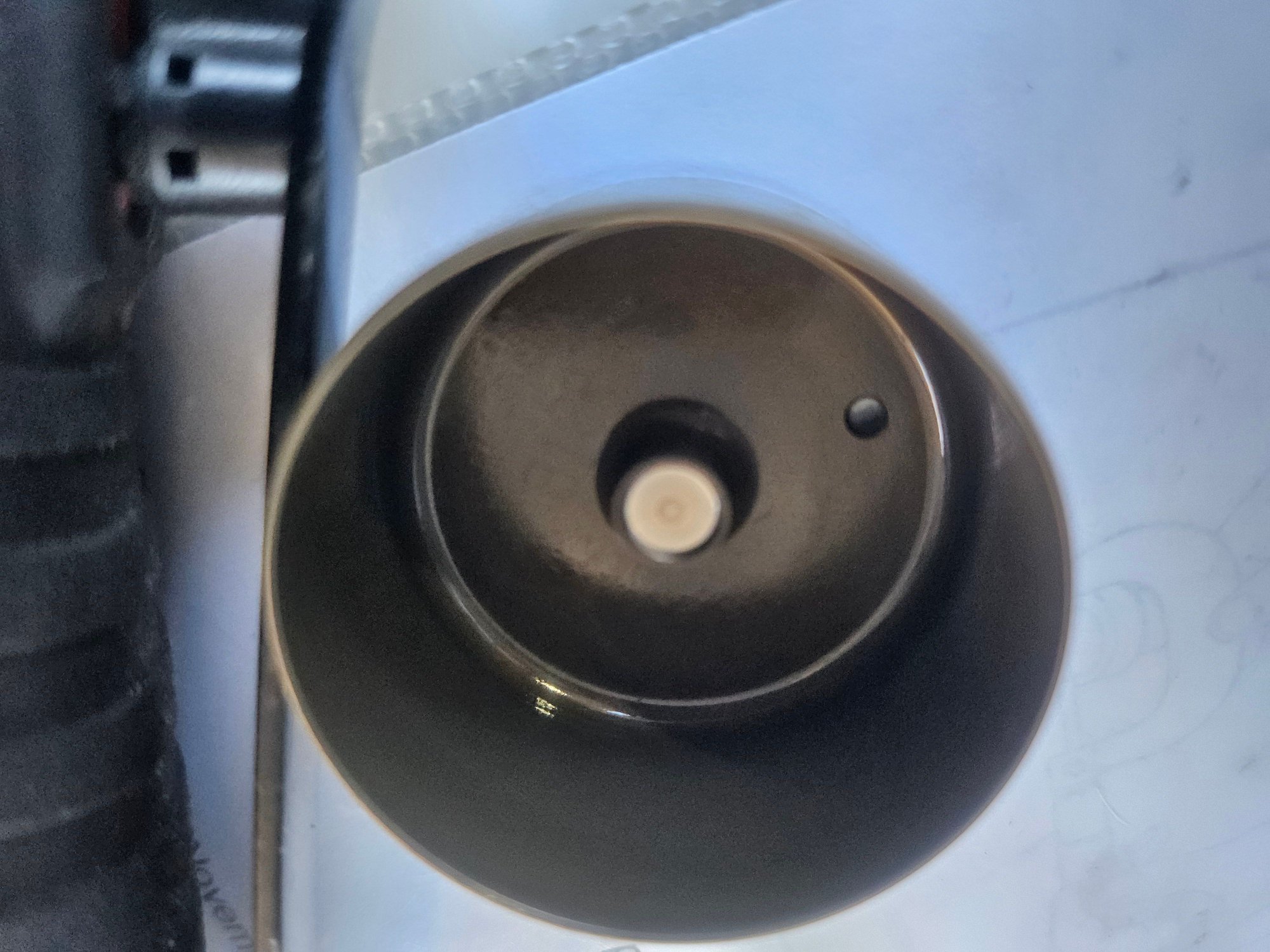

Old Jun 7, 2025 | 01:03 PM
bre240z's Avatar
bre240z
Joined: Dec 2021
Posts: 437
Likes: 134
From: La Puente CA
Update
The ticking noise continued so I finally got some time to remove the valve covers and take a visual inspection and chech valve lash.
Unfortunately all valves are to spec but 1. One of the exhaust vavles on cylinder #6 is way out of spec. Should be 0.011 - 0.015 the valve lash on this one is 0.024. Way off. Im not sure how this happended. I know these can get out of spec but 0.024? That's excessive wear unless this is common. Anyway it's time to get a jdm motor and swap it out in the near future. The plan from the get go was to rebuild the original motor regardless and put in some better rings and what not to freshen up the motor. So when im ready for that I'll send the heads and block to the machine shop. For now I'll have my son continue driving it
Old Jun 9, 2025 | 04:52 PM
icer5160's Avatar
icer5160
Joined: May 2010
Posts: 2,074
Likes: 619
From: Brentwood, CA
Very odd indeed! That's a very clean cylinder head by the looks of it. You've clearly been on top of maintenance. My theory is...maybe a combination of heat-soak and oil pressure? It's pretty typical for the rear cylinders to get a bit warmer/hotter compared to the front cylinders. This is mostly because of the coolant routing as it flows through the block. This could also be related to oil pressure, crank mains and rods get 1st dibs on oil, the valvetrain components are usually the last in the loop. The backs of the cylinder valvetrain probably have the weakest oil pressure. I like to think this might be part of the reason Nissan upgraded the oil pump when the Revup DE released (aside from adding variable valve timing on the exhaust cams).
This is just my theory, purely anecdotal.
Cheers!
-Icer

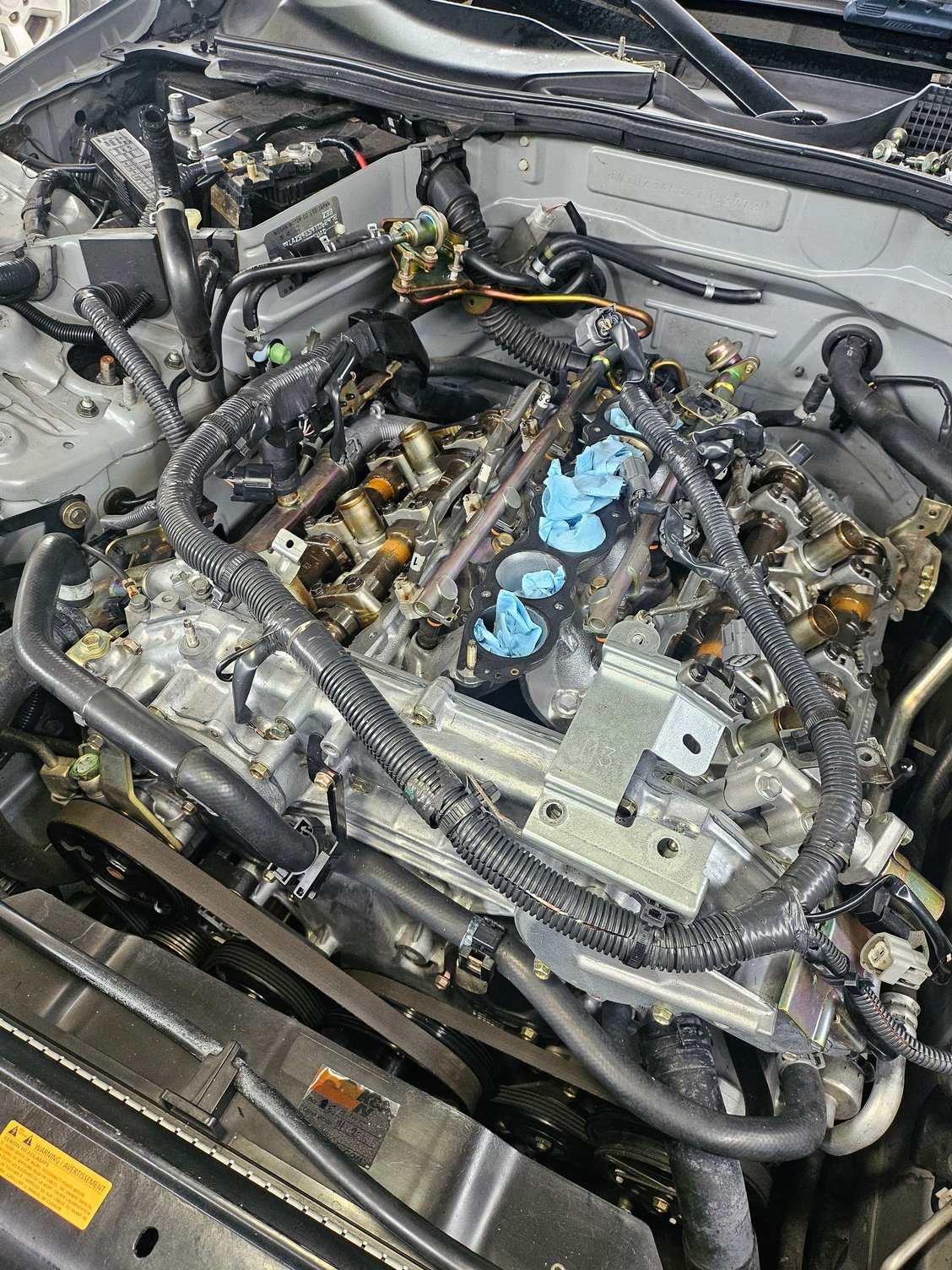

Old Sep 25, 2025 | 09:25 PM
bre240z's Avatar
bre240z
Joined: Dec 2021
Posts: 437
Likes: 134
From: La Puente CA
Update
Started On the bucket replacement. I have everything off. A lot of work to get to this one bucket. Very intimidating removing all the timing components but im really getting to know the VQ.
damaged bucket below
Old Sep 26, 2025 | 01:59 PM
icer5160's Avatar
icer5160
Joined: May 2010
Posts: 2,074
Likes: 619
From: Brentwood, CA
Great progress!
What's the P/N of the spring bucket? Have you figured out what new bucket you need? Are there markings on it to indicate what the existing spec is vs. what you need for new? That's the part that confuses me, you know the gap is .024 which is nearly double what it should be, so how do you convert that knowledge into the replacement bucket to bring it back into spec?
Cheers!
-Icer
Old Sep 26, 2025 | 10:24 PM
bre240z's Avatar
bre240z
Joined: Dec 2021
Posts: 437
Likes: 134
From: La Puente CA
Icer there's an equation on the fsm to determine what size bucket you'll need.
t1= thickness of removed valve bucket
c1= measured valve clearance
C2 = standard valve clearance: in my case exhaust 0.33 mm
t1+(c1-c2) = thickness of replacement bucket
In my case I needed a 8.08 mm bucket that brought the lash back into normal range.
I bought a set of oem used buckets on ebay for $70 12 buckets. I figured I'll get lucky and get the size I needed and I did. Z1 sells that one bucket for $70 + shipping. Local dealer wanted $83 for just 1 bucket.
If anyone needs to replace a bucket I have several of them different sizes that im willing to give away if anyone needs one.
Got the replacement bucket on today and im just waiting for Z1 timing covers o ring/seal kit to arrive monday to start putting everything back together. Anxious to get the car started.
