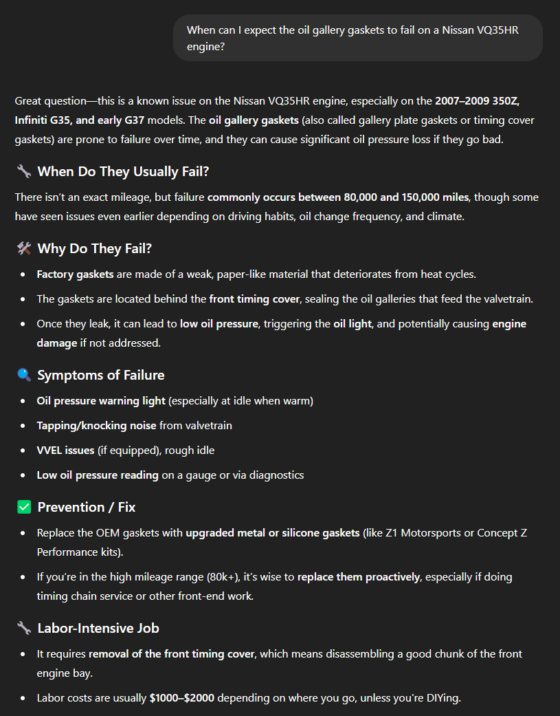

In your opinion, is gasket failure guaranteed to happen to an HR at some point ? Is there an average mileage when it does and what are the clear obvious signs ?
Nothing is guaranteed to happen. Yes history has shown that HR gallery gaskets are prone to failure but doesnt necessarily mean it will happen . Same goes for the early DE manual transmission. Youll read about how they have bad synchros and go bad which will need a replacement or upgrade to a CD9 but theres plenty of members still with their stock DE transmissions going strong with no issues... including myself. Never had any issues with my transmission.
Theres a lot of factors here. How much the vehicle is used and how its used. Whats the maintenance like and so on. Dont beat yourself up on this. If your Z is running great and not showing any signs of issues just keep up with the maintenance and drive it. Now if money isnt an issue for you then go ahead and change all those parts out.

Thanks man. Finally a voice of reason. It did sound weird to me to worry about something that may or may not happen

I agree with Mic an Bre. Take with a grain of salt, but I don't think you need to make preparations for the maintenance until you're closer to 100k. The good news is you are aware of the problem and thus can catch it should a failure occur. Here's what ChatGPT says.
