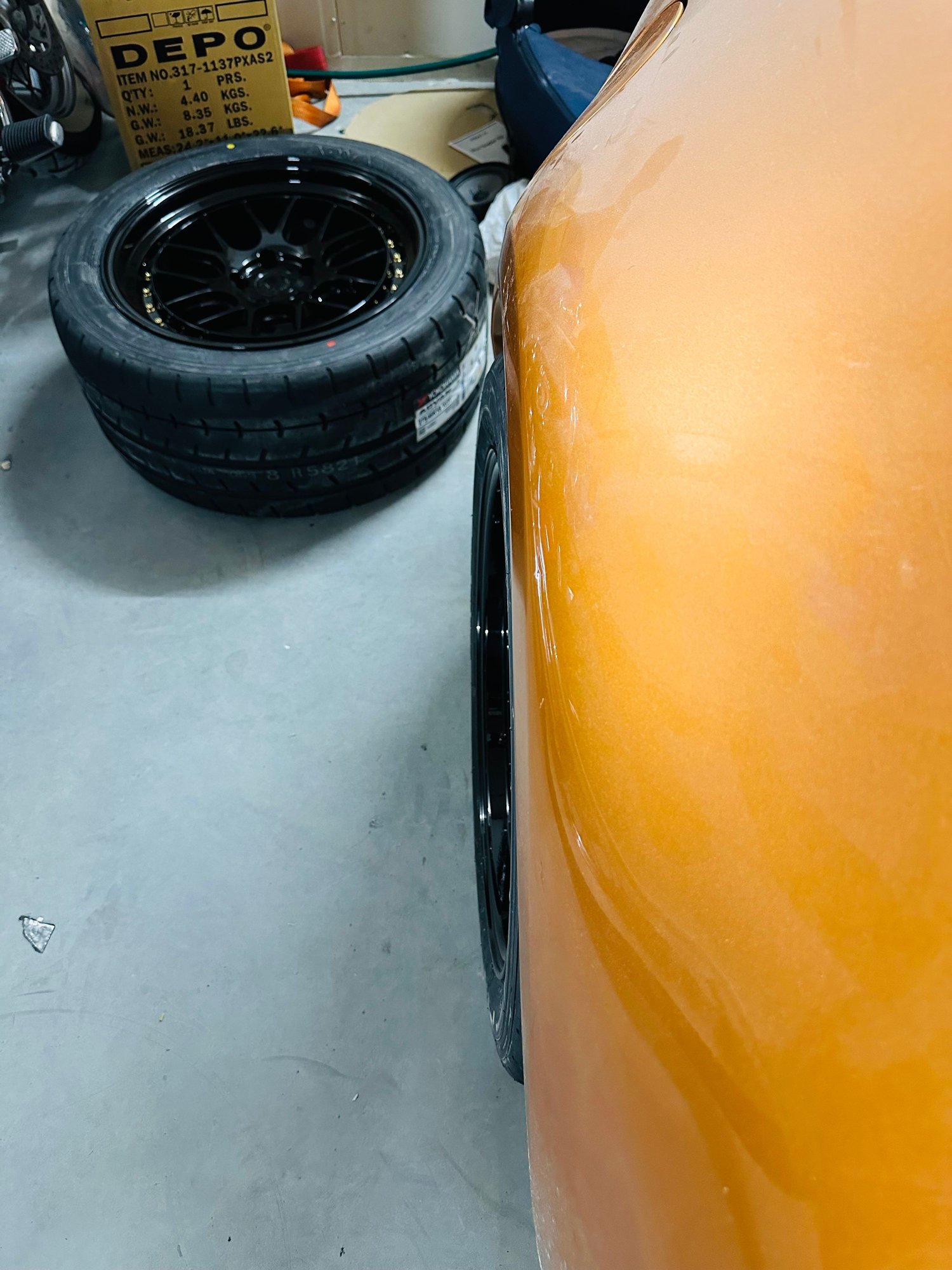

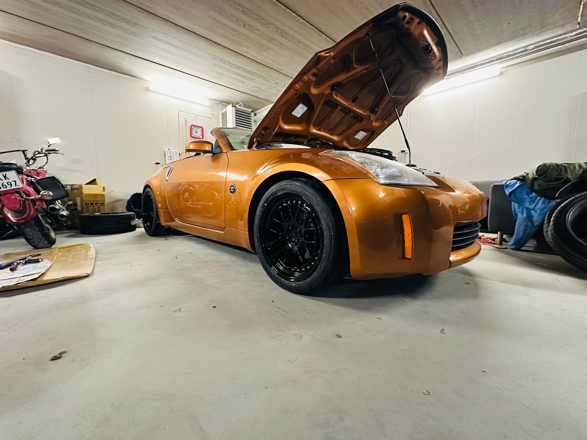

My Z has been sitting, getting paint - wheels, stereo etc. All has been fine.

Fresh paint om most of the car, new wheels and tires, full service, stereo, bushings, soft top... So I was just SO ready! haha.
