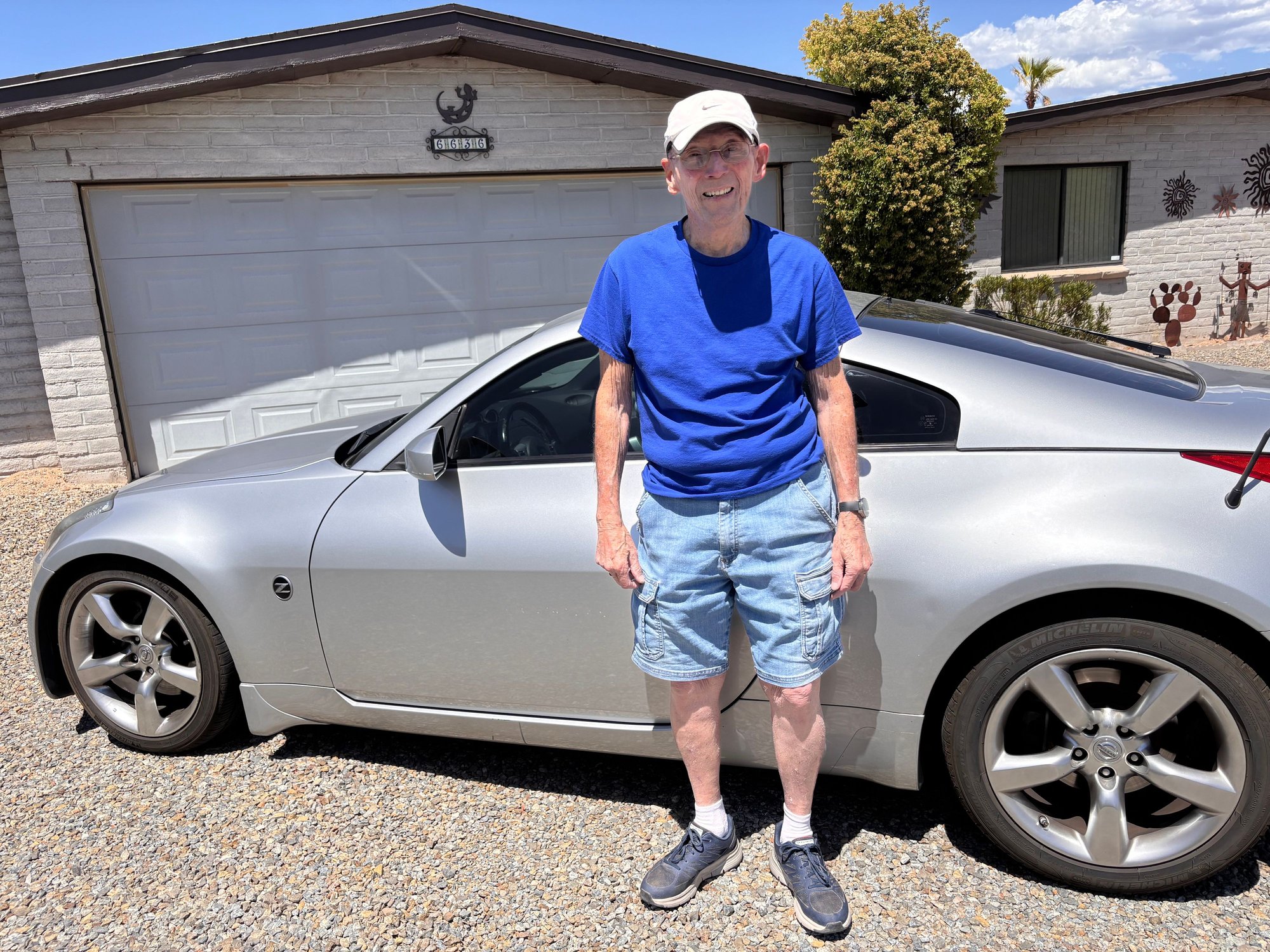

Old May 2, 2025 | 12:42 PM
trains1937's Avatar
trains1937
Posts: 660
Likes: 143
From: Tucson, Arizona
Me and my Z five minutes ago.  Pic taken by my wife.
