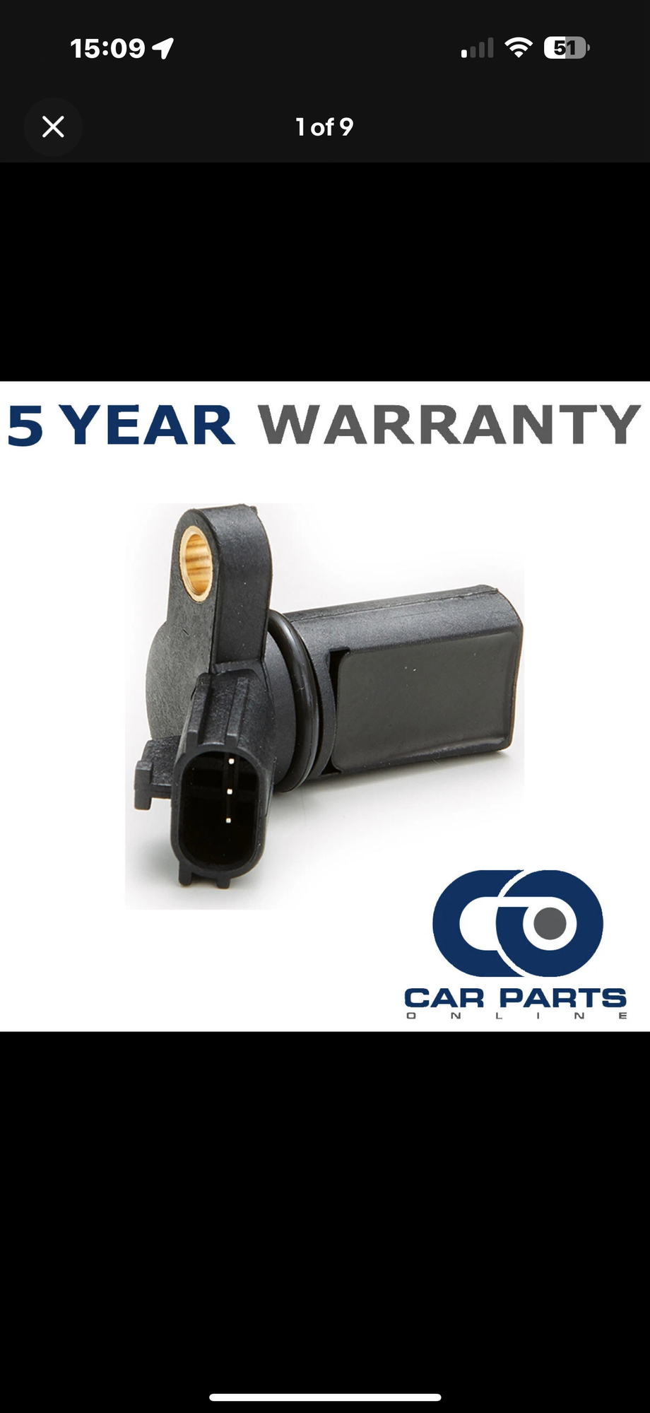

Post the sensor you changed it with

It was just a cheap one off eBay as it needs an MOT so wasn’t spending upwards of a 100 for one just to pass an MOT but this is the one I got for like £20, the car hasn’t driven yet and the cam shaft sensor is brand new

Non oem.sensors are known to cause issues
Yeah I read up on that too, the car hasn’t driven since having the sensor installed so it should be fine, so is it worth buying an OEM one instead?

If you replaced the sensor with that cheap aftermarket one and the code is still there with the hesitation in starting, then yes. Get the OEM sensor.
