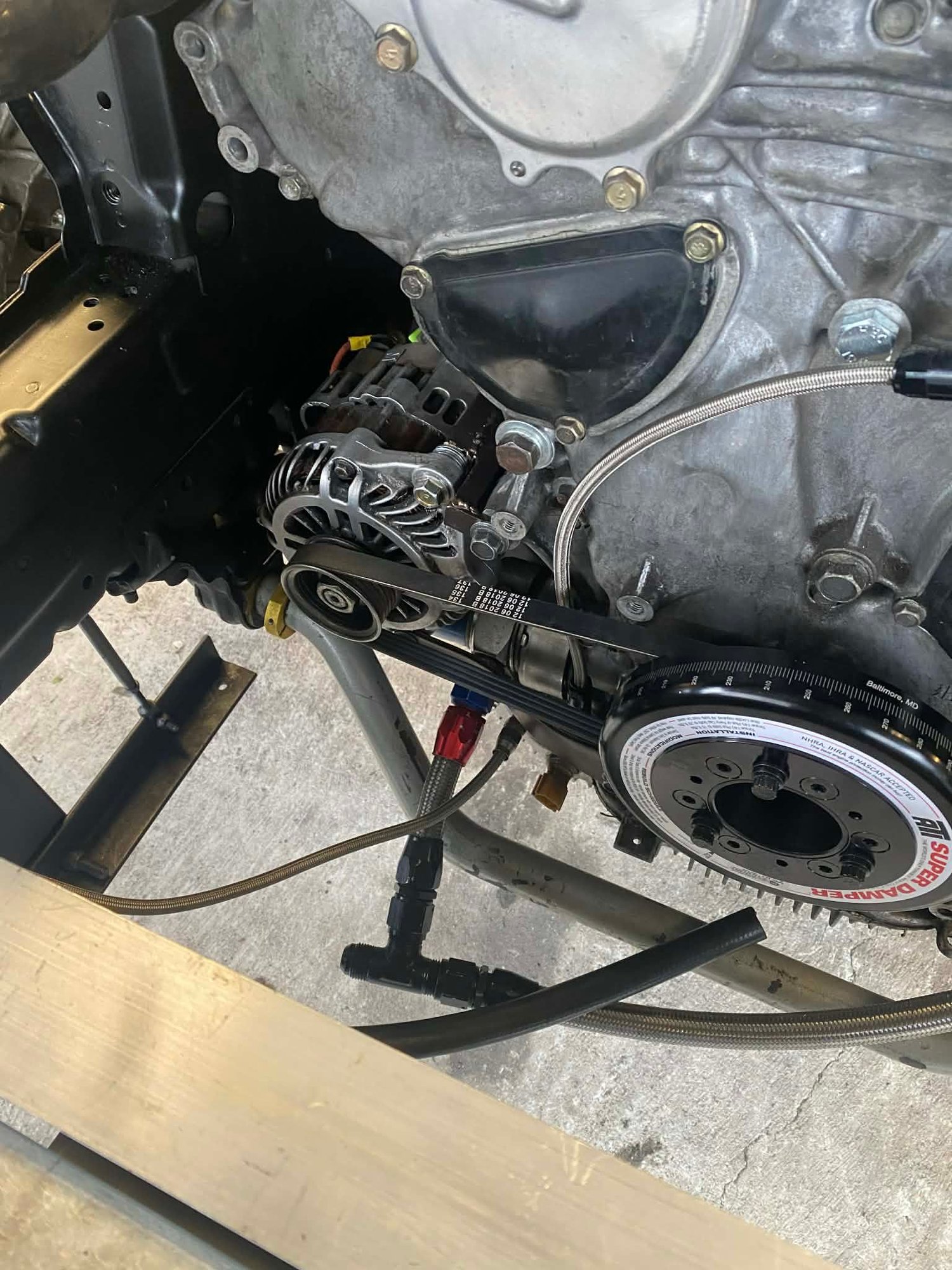

hey all, i have an ATI race balancer, as i thought as i just have altrenator to drive it would suit, but its not aligned with original Alternator now. so, does anyone make a bracket? or will i just need to fab one up myself. cheers

made own mount, no one sells one

i ended up speaking to ATI, the race balncer does not align with stock alternator location. i have the Race version for the DE.

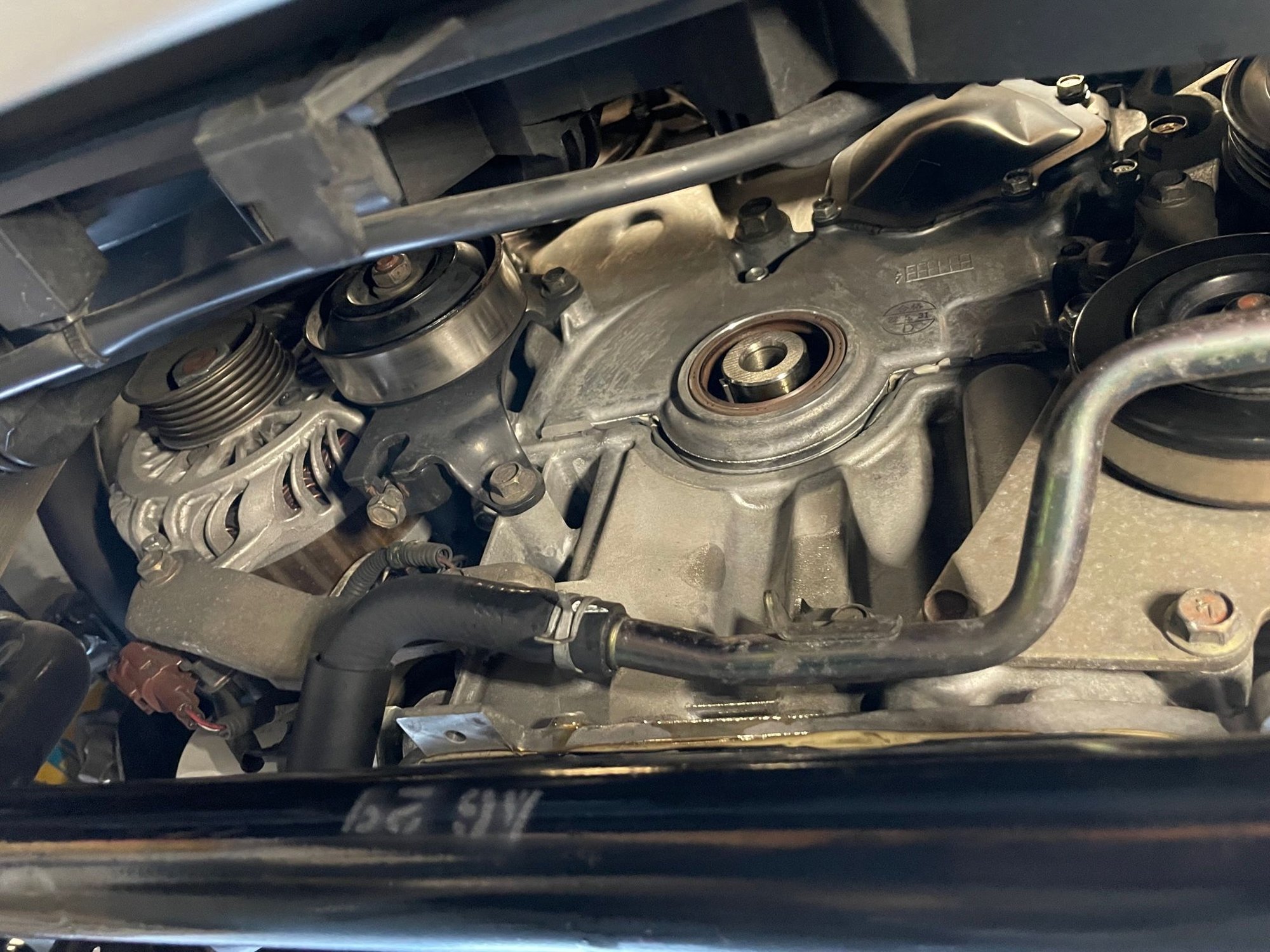

Looks like you're missing the tensioner bracket, but looking closely, there's no way it would have fit with the race spec ATI damper (see photo). Looks like custom fab was your best option. Good work! Looks clean!

dont need the tensioner, now i can adjust tension with alternator bracket, and yes it wont fit anyway.
