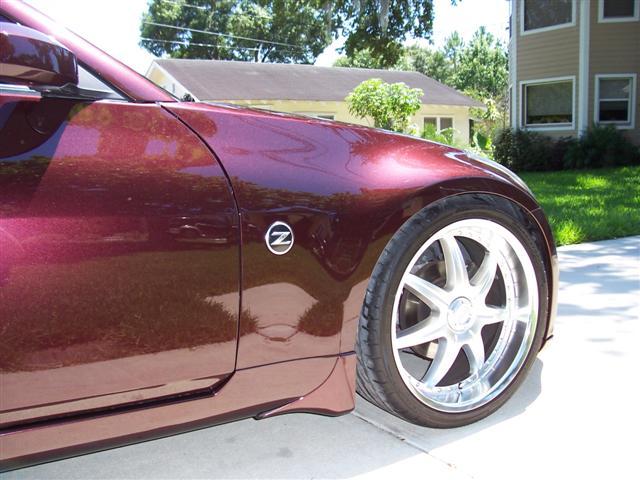

p.s. DAMN, what kind of wax do you use?

As far as wax: I use Menzerna polishs. Then apply one coat of Blackfire polymer wax then a coat of P21S carnuba wax. Then I do a once over with Blackfire detail spray.
Here's an up close pic.
