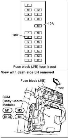

Just noticed last night that the security Indicator LED on the top of the dash is not blinking and will not come one when the car is locked. Has anyone had this happen before?? All the doors, hood & hatch are closed and the car locks and unlocks with the remote fine. I was going to check the fuses but I can't find a list of what fuse is for what accessory. I went thru the manual and didn't find anything. I aslo opened the little trap door over the fuse block figuring there might be a key to each fuse but nothing..

Now that I'm home and can look at the service manual....
Look at the 10A fuse in slot #19 as shown below

Thanks for all the tips. All the fuses are good. I did try the alarm and it works. I think the LED has gone bad. We had a lightning strike very close to my house the other day and it caused the remote module in my GMC Yukon to go crazy. The doors we locking & unlocking by them selves. I cleared it by starting the car and letting it run a while. It's fine now. Must have been the static charge from the strike. It was so close, I could smell it! I noticed the "Z" security alarm LED out the next morning. The car appears fine and dosn't exibit any problems. Guess I can always bring it to the dealer..
