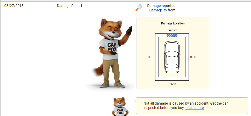

i was thinking the front end looked a little off, the hood and bumper line

yes,i see that also on the drivers side, the confusing part is it appears to be missing the Nismo body kit.
