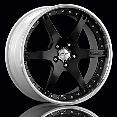

Back on topic you won't have any problems with 20" rims fitting as long as you stick to the right offsets and tire size. Being your BF works at a tire shop he shouldn't have any problems figuring out what sizes to go with.
Here's a sample for Black OZ Galileo III's (with polished lip)
Front (20x9)
offset: 34mm
Tire Size: 245/30-20
Rear (20x10.5)
Offset: 40mm
Tire Size 275/30-20

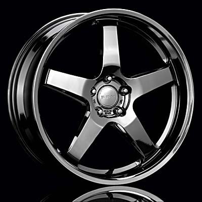

EDIT: Here's some Black Chrome Ray's
Front: 20x9.5
Offset: 25mm
Tire: 245/30-20
Rear: 20x10.5
Offset: 30mm
Tire: 275/30-20
