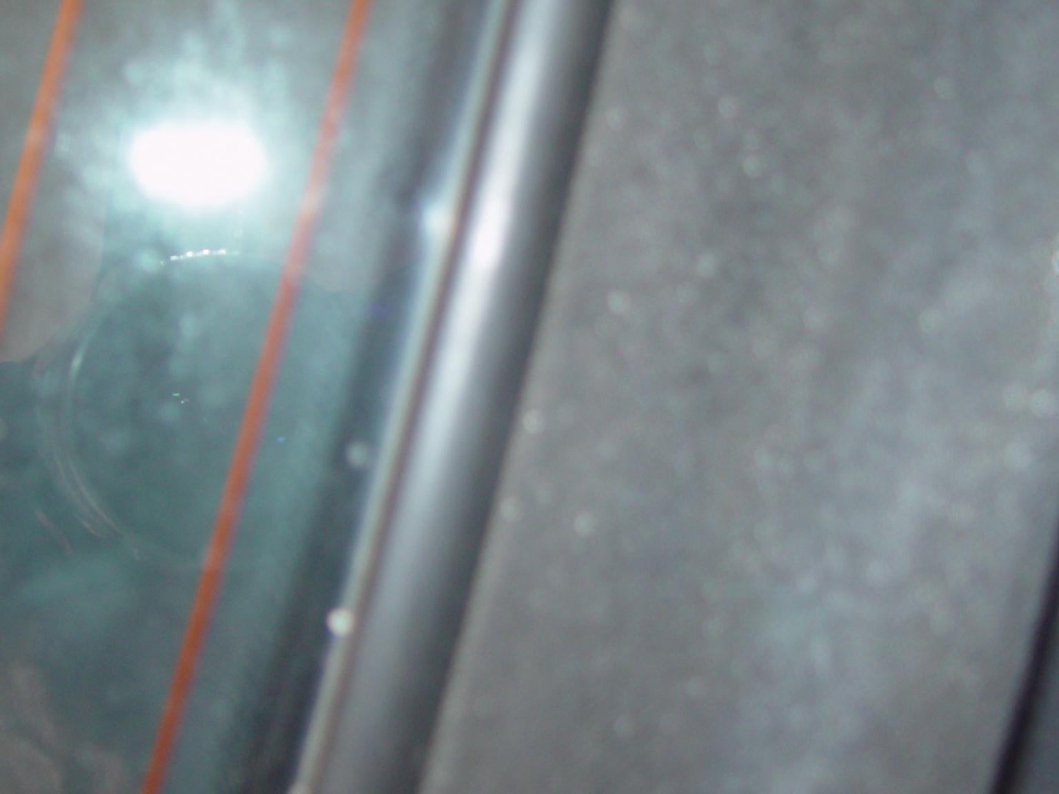

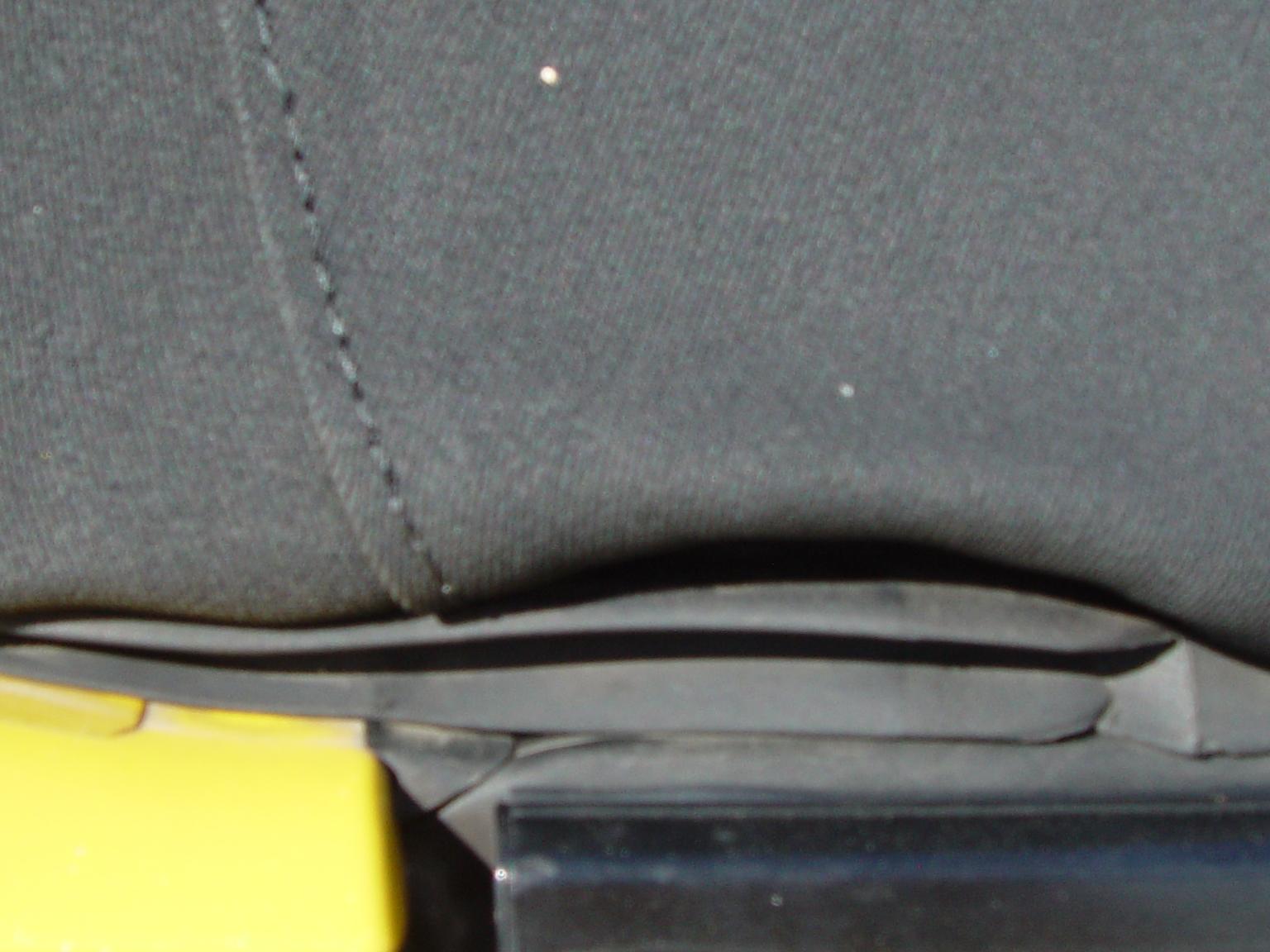

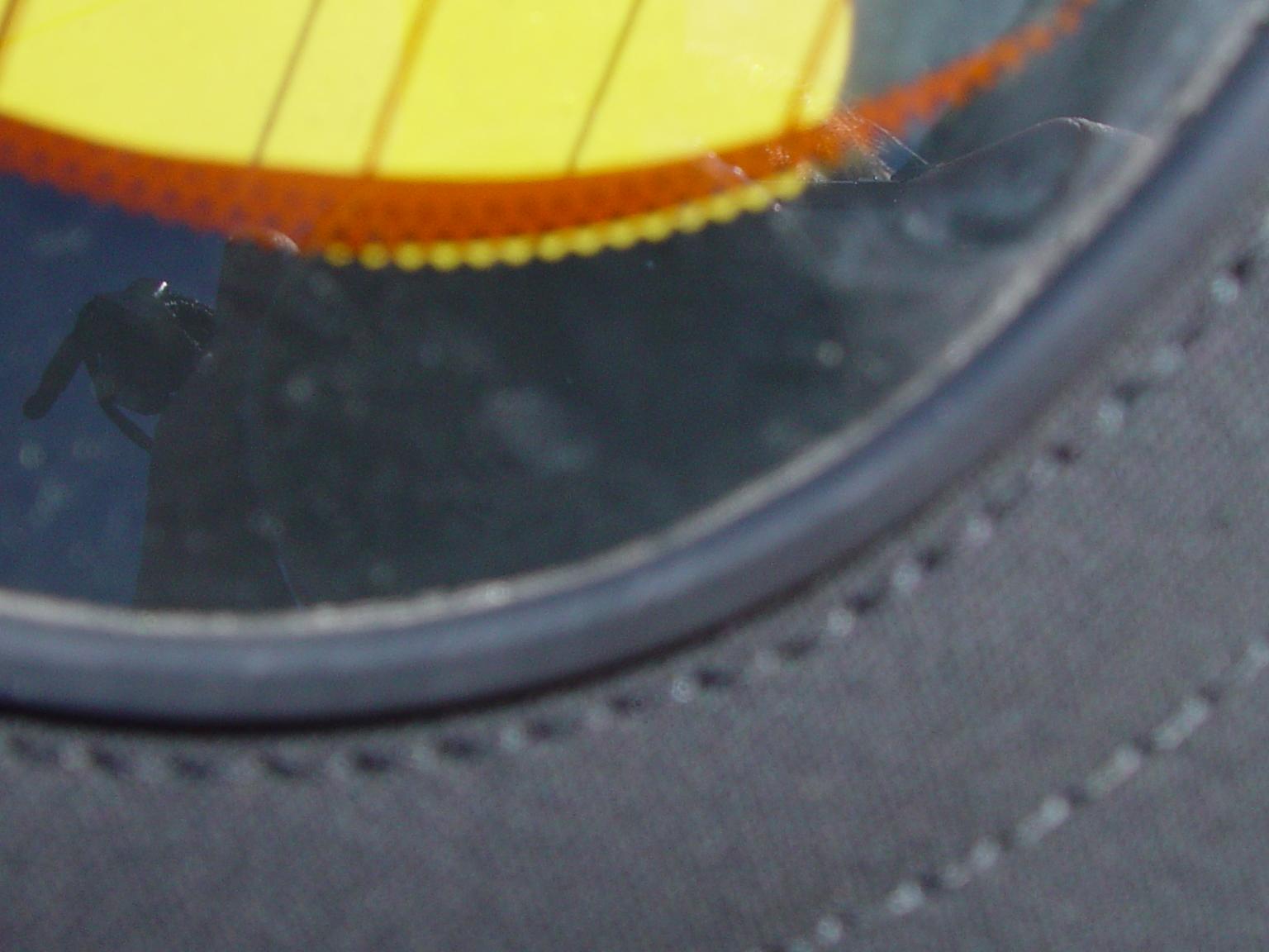

Finally getting around to posting back in here. Took a pic of the old rear window and new window plastic trim area so people can see the difference in them, someone had mentioned in some other thread how the top got didn't have the black trim, this one did but has extra seams around it also.

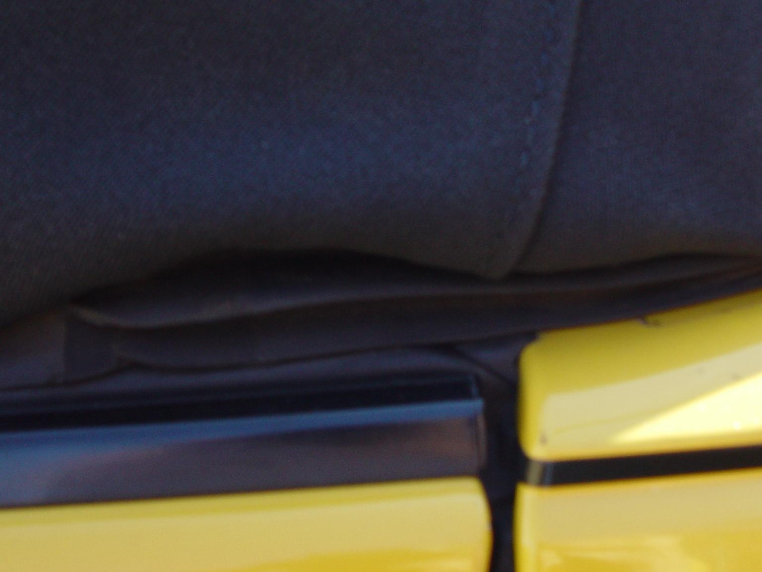

Still can't get this area to 'seat' look right, don't think the old one looked like this but I can't see anything to pull it tighter. It's the part right where the door closes between the door and the hatch cover.

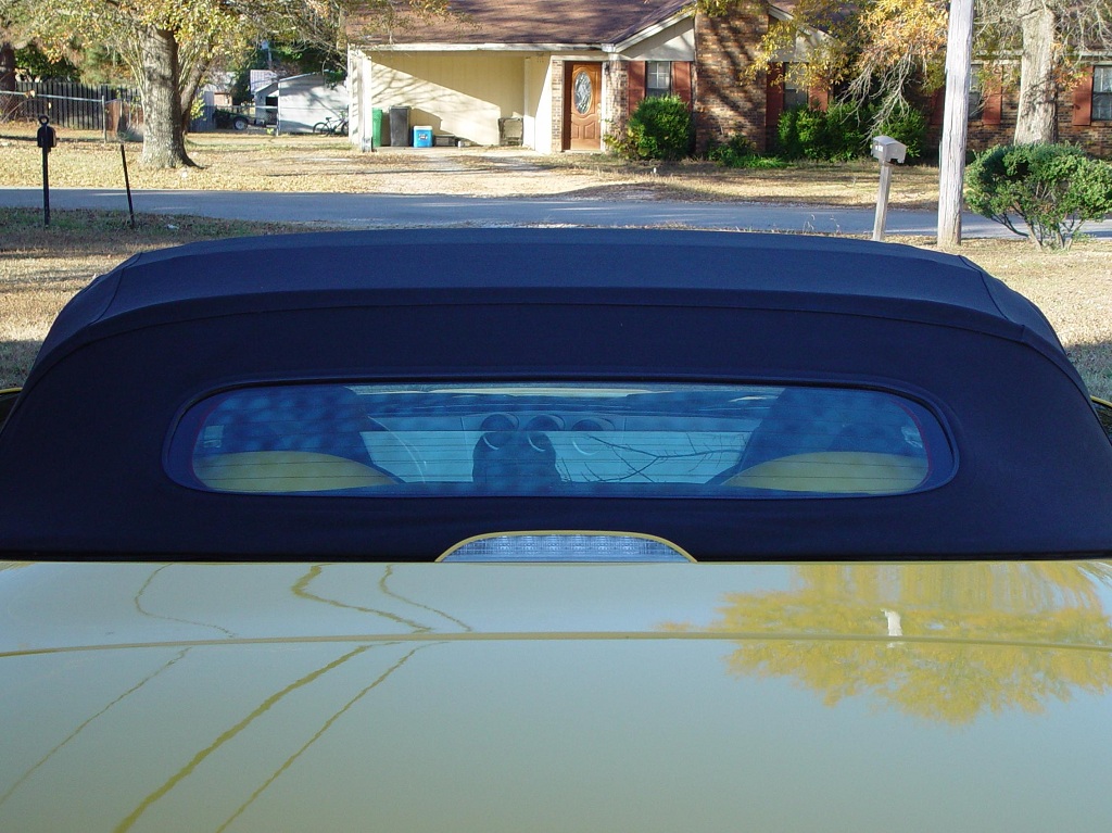

You made me wonder so I had to check. This is stock '05 - fyi.

Cool, thanks for the pic. I looked over the modified pics of roadsters but couldn't find a good pic with a top up. Just need to wash it and put some raggtopp on it so it's nice and black like yours

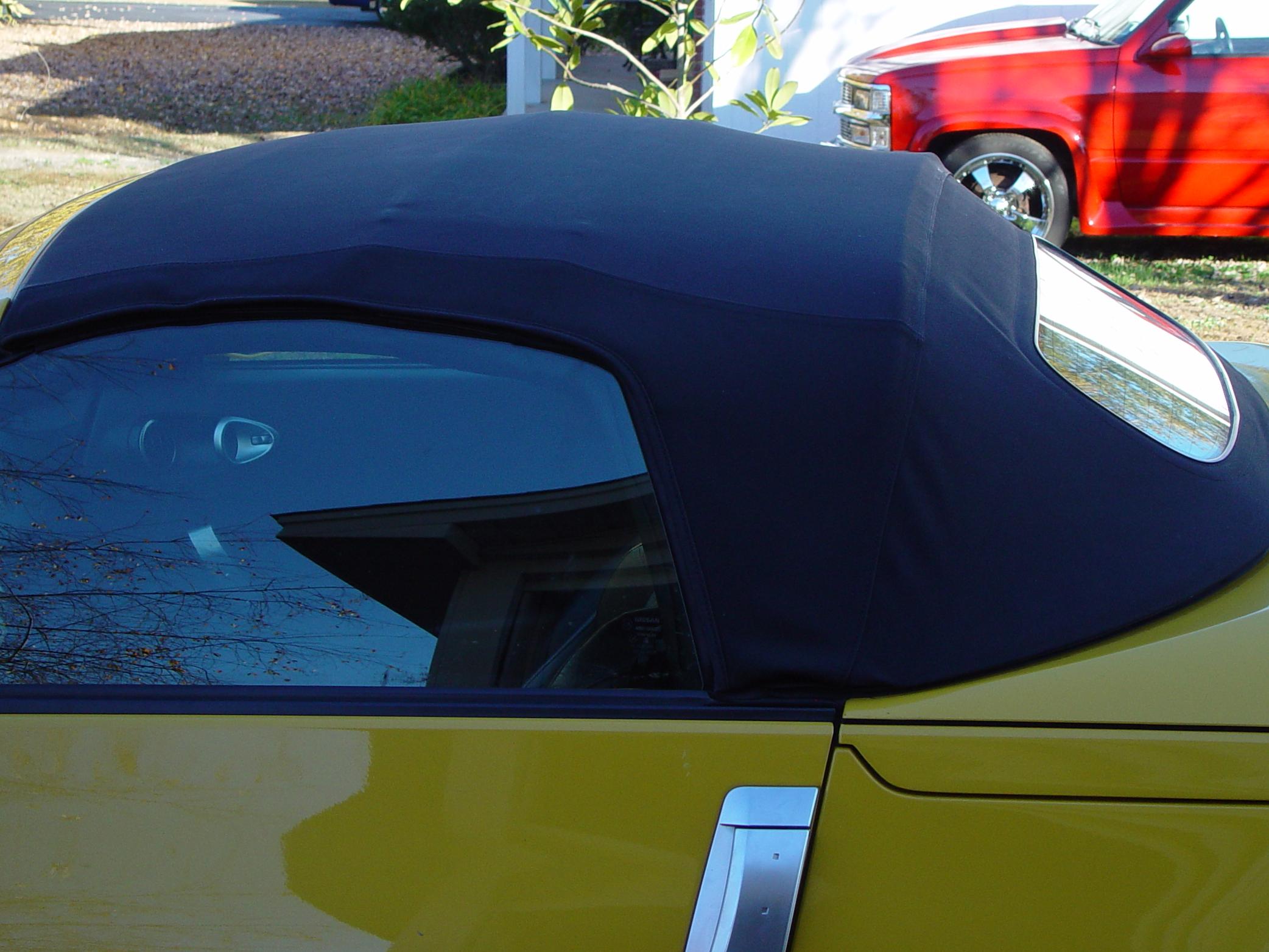

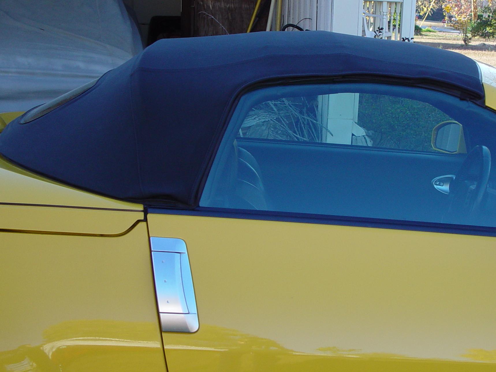

For pictures, not sure how far away you meant, so took these.

The 2 'grey' squares you can see where the defroster wires attach I haven't had the chance to remove yet. They stuck 2 pieces of foam there to keep them from being damaged and the adhesive was really on there and just haven't gotten around to getting in there with some cleaner to remove it.

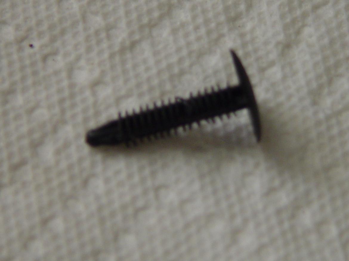

And the piece I had no idea where it went, anyone know where 2 of these dudes go? I know I put the ones back in on the front, doesn't seem to be a issue with them missing and I'd really hate to tear a bunch of crap back apart for nothing.

One place that gave me the most trouble and isn't covered well in the manual, the part I showed above where the door closes and it doesn't seat right, there's a screw up under that , very hard to get to, need a short 2" phillips or a L shaped screwdriver to really get at it, or was for me. The head faces down when closed and the screw itself goes straight up into the top for reference.
