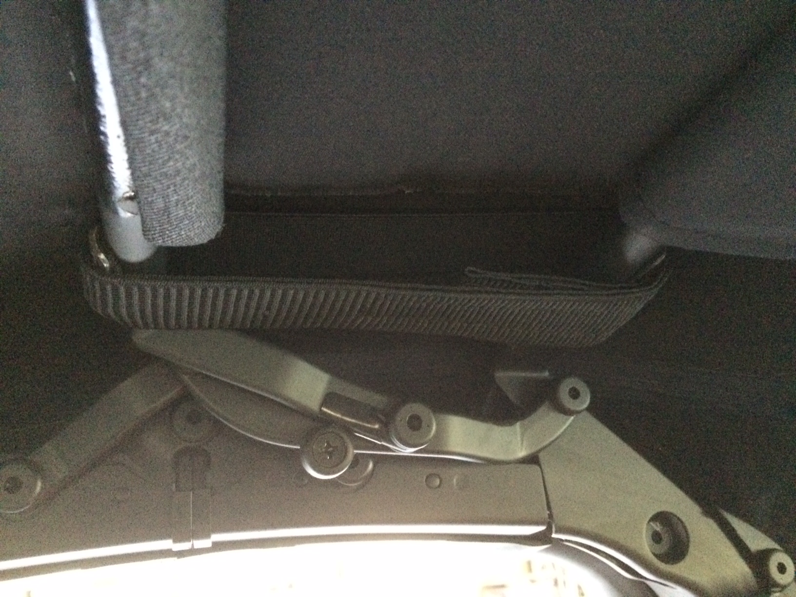

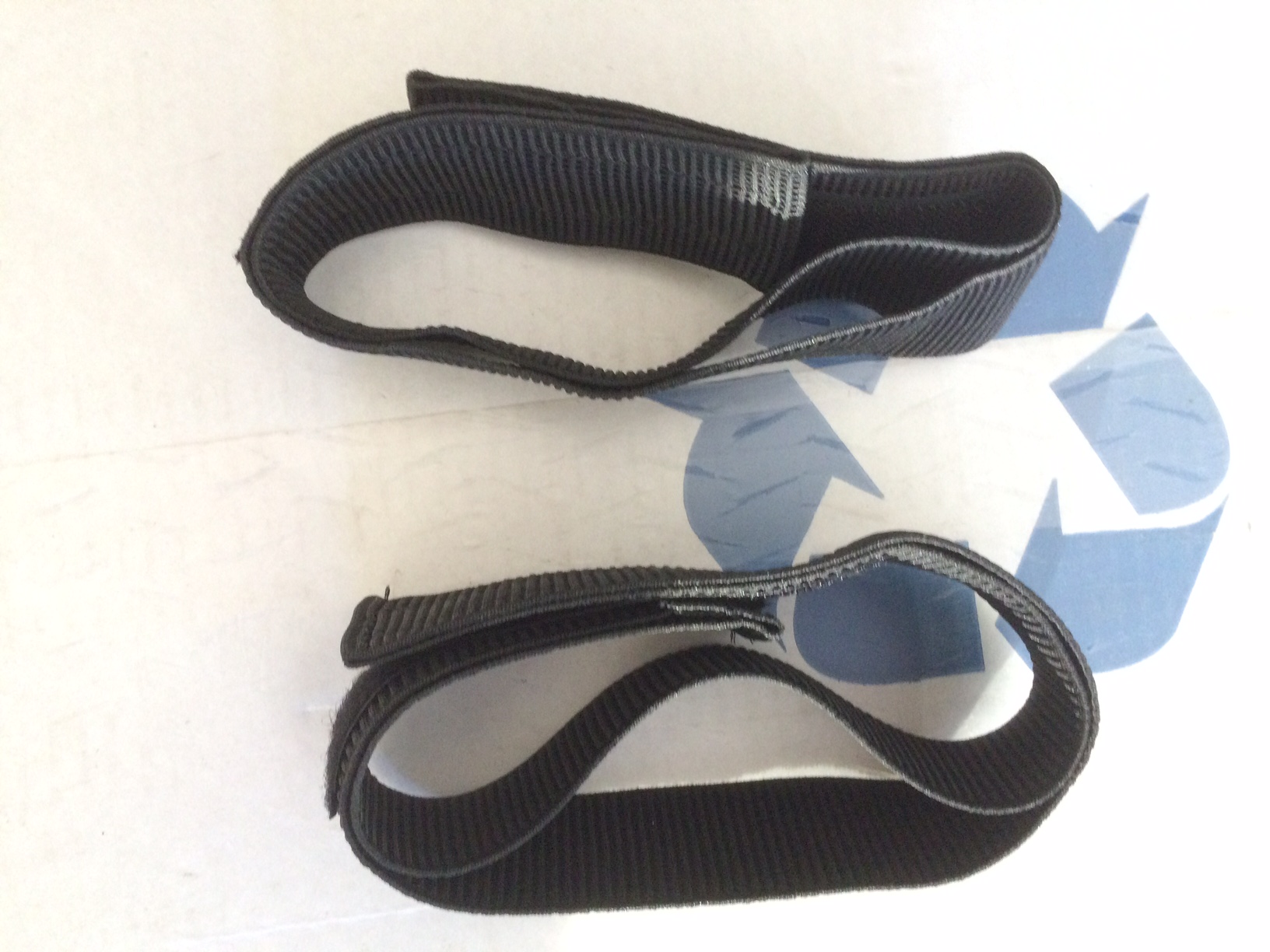

I picked up the wife an 07 roadster & the top does not come down without a little help (pushing on the top cross member) anyways this is more than likley covered BUT I could not find a thread that did not involve drilling out the factory hold downs for the straps.
This is what I did to fix the problem cost me about $20 as my sewing skills are nil.
$10 material & $8 to get a seamstress to sew then together.
Material
2 x 34" x 1.5" reinforced elastic
12" velcro
I doubled up on the elastic to give it more strength so each piece is 17" long, Velcro on each end (about 4")so I can make a circle that is adjustable (hope that makes sense)
I used the factory locations where the elastic bands are and just went over top of them.
Seems to work.
Colin

Thanks Colin, I did this seems to work only been a couple days , I did do it a little different I used a different elastic strap it is 2 inch and I used adhesive backed Velcro . I cut it to the 17"s as you stated i then put the 3' long adhesive backed Velcro (since the Velcro I used was 1' wide I put 2 strips 3" long side by side) so i eliminated having it sewn together
bought at Amazon
