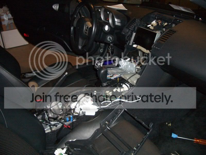

Haha, well, if this looks clean to you, then yes, it's clean lol!!
But no, on a more serious note, it's quite easy to get it installed, if you don't have GPS. If you have GPS, then you have a bit more to remove before you can get the stock headunit out. But it was very straightforward. I'm sure the basslink would be perfectly fine and even easier to hook up to an aftermarket HU than it would be to the stock bose. Take a look at the headunit I got. Not a bad price ($250) from Crutchfield.com and they'll send you (for free) not only the double-din cash fit (that gives you the bottom pocket for storage as well) and also the wiring harness. Not a bad deal. But anyways, the headunit I got looks quite well and compliments the brushed aluminum finish of the 350Z interior. Might be worth taking a look.
