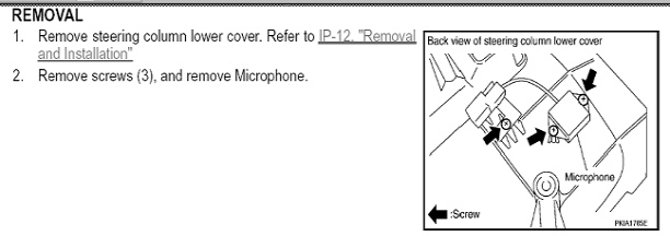

I agree with alot of what has been said about the stereo being a big dissapointment. Even after the amp replacement the bass is now gone and the subwoofer basically does nothing now.
This weekend I am going to disable the audio pilot microphone and see if this helps. If anyone else wants to give it a shot here is the short description from the service manual on the audio pilot function and how to remove it.
Let us know if that's a solution to the problem (disconnecting the mic). It's not that big of a deal for me to reach over a (manually) turn the volume up or down. I'd much rather do that than continue dealing with Nissan over this problem.

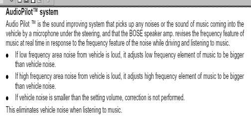

Nope, the probelm is in the amp located in the rear of the vehicle that controls the Audio Pilot which is connected to the mic that "listens" for cabin noise and raises/lowers the volume.
For more info. on the Audiopilot and the bose system in general (complaint related), please see: https://my350z.com/forum/showthread....threadid=13004

I will be taking out the mic this saturday and see what happens. I will update this thread with the results.

I am an engineer with significant audio hardware design experience. I would caution anyone in simply disconnecting the microphone and leaving that input entirely unterminated. Leaving it open may work OK but could cause widely varying performance, (at different times, unexpectedly). Information in the service manual suggests that it is a "condenser", (capacitor), mic.
Try this instead:
Obtain a 100 microfarad tantalum capacitor, (~15 volts min.), a 1K, (1x10e3), ohm and a 1 Meg, (1x10e6), ohm film resistor, (.25 watt min.). Radio Shack, etc.
Solder one end of the 1K resistor to the positive terminal, (wire), of the capacitor.
Solder the 1 Meg ohm resistor from the capacitor negative terminal to the open end of the 1 K ohm resister.
Unplug the microphone connector at the microphone.
Connect the wire from the negative capacitor terminal to microphone connector pin 2, (Blue/Green wire), and the junction of the 1 Meg ohm and 1K ohm resistors to microphone wire connector pin 1, (Blue/Yellow wire). Be sure that no bare wires touch anything, (electrical tape, whatever).
Doing the above will preserve the DC voltage, (mic. bias), and short the AC, (sound), components to the microphone input. This should make the amp "think" that no sounds at all are present, and hence it won't have to do anything to change audio levels, etc.
I haven't had time to try this approach on my car yet. So far I have put electrical tape over the mic. holes and this has helped somewhat but low frequency vibrational components still have an effect. Regardless of how well this does or does not work, it is better to do this that either shorting together or opening the microphone input to the amp. Shorting the input could cause damage to the amp module. Explicit technical details of the audio hardware would provide better information that could yield a better solution. Based on a number of posts I've read, I'm definitely NOT going have the Bose amp replaced per the Nissan TSB. This TSB does not appear to be a definitive proper fix for the problem. The proper fix would find all those who used it in complete agreement as to the performance result.
Good luck!
