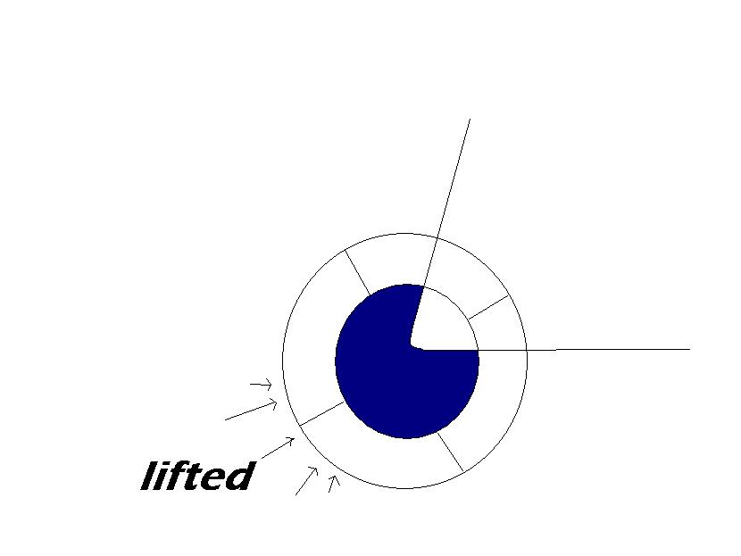

In the crude drawing here I'm trying to show where the window on the passenger side hits the magnet. It is on the aft top portion about 1 1/2" back from the steel door frame.
If a spacer was created and angled to push the speaker outward, with the highest point under the area that I put the pointers on, I don't see how that is pushing the magnet any further away from the window. In fact the point that would be furthest away from the magnet would be the front of the magnet..which was already clear of the window in the first place.
I've never understood how people got more clearance with the angled spacers. Better imaging, reduced rainbow effect and less blocking by the door panel yes..but more clearance, I don't get it....
By creating a spacer of .25 near the seat and 2.5 inches at the other side I was able to install the CDTs this weekend..took 4 hours to get it just right but I got it done. Thanks guys
