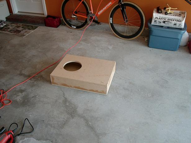

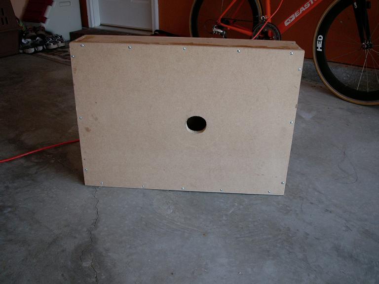

ok i finally finished my trunk floor sub project! whatcha think? this is my 3rd setup, and by far the best IMO. sounds killer, hits hard and surprisingly low being a sealed box. sub is Fosgate T1 12 D4. airspace is 1.3 cu ft sealed.
first off, here is the box.....20x28x6-approx

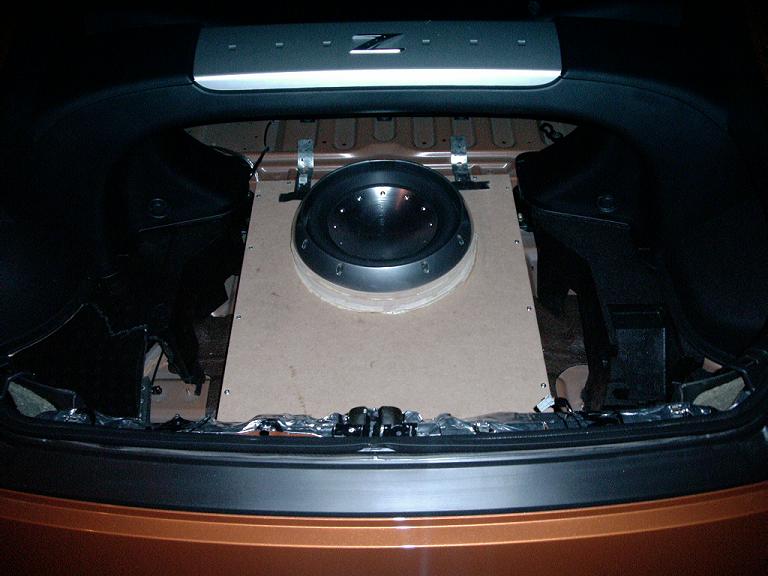

next, i had to build a couple of spacers to accomodate the new sub depth...

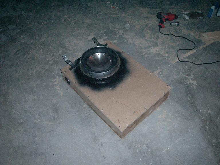

then i used some wood filler and filled all the "gaps" in the spacers and then primed and painted black before coverig just the spacers with carpet...

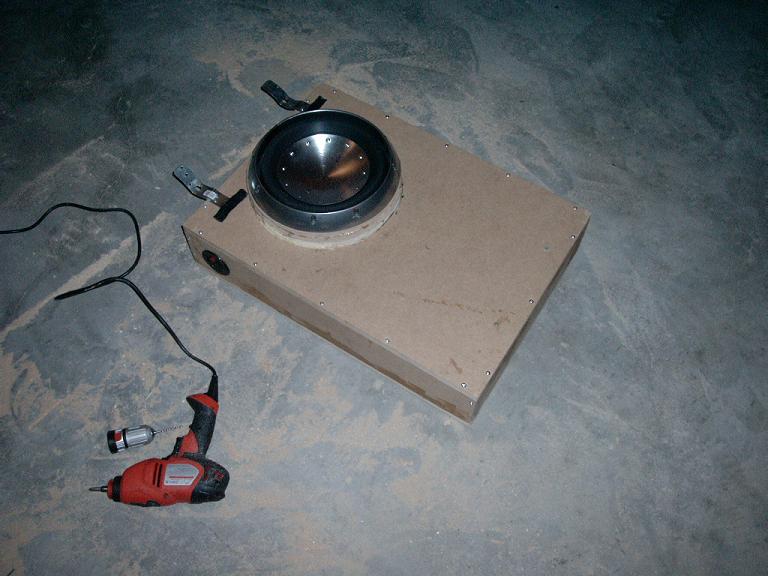

test fit....

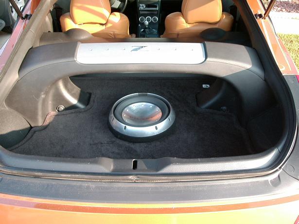

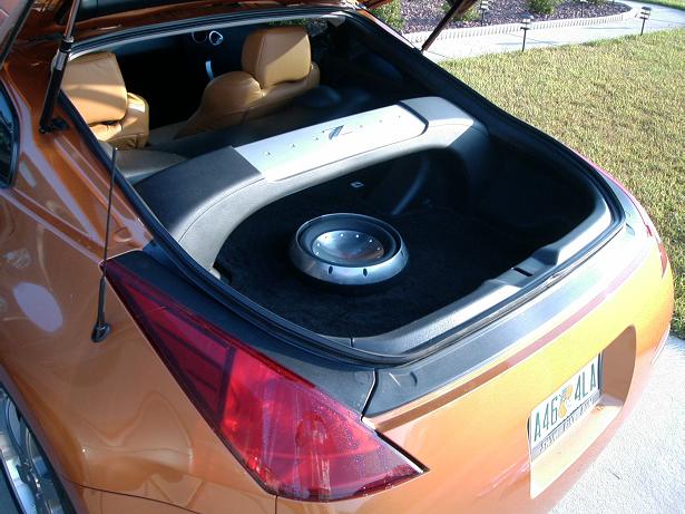

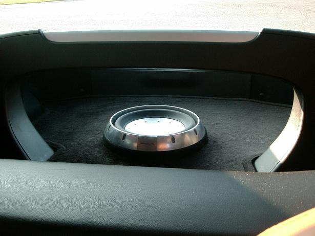

voila! finished product......
Attached Thumbnails finally fiished sub box!-box6.jpg   finally fiished sub box!-box8.jpg   finally fiished sub box!-box7.jpg

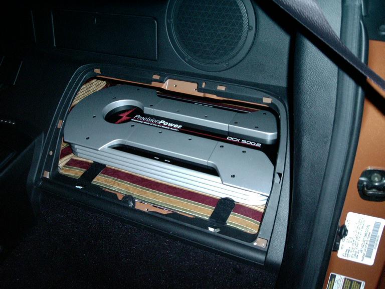

oh and here is the amp, Precision Power 500.2 behind driver in cubby..
i was going to build up a new floor instead of having it stick out that extra inch and a half, but i kinda like the way it looks right now. dunno maybe later. looks alot better i person as well, pics really dont do justice.

i gotta tell ya, it sounds so much better than i was expecting, especially being a sealed box. it is actually quite overpowering. hits like crazy, and gets surprising low! plus i love the way it looks! now i know Fosgate isn't supposed to be a good as they used to be, but let me tell you all this sub is fairly excellent. for the price and sound, i am completely satisfied now i just gotta get me some components to even it out
