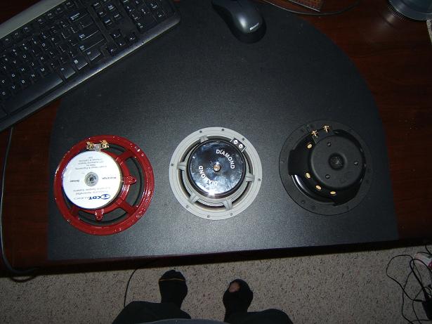

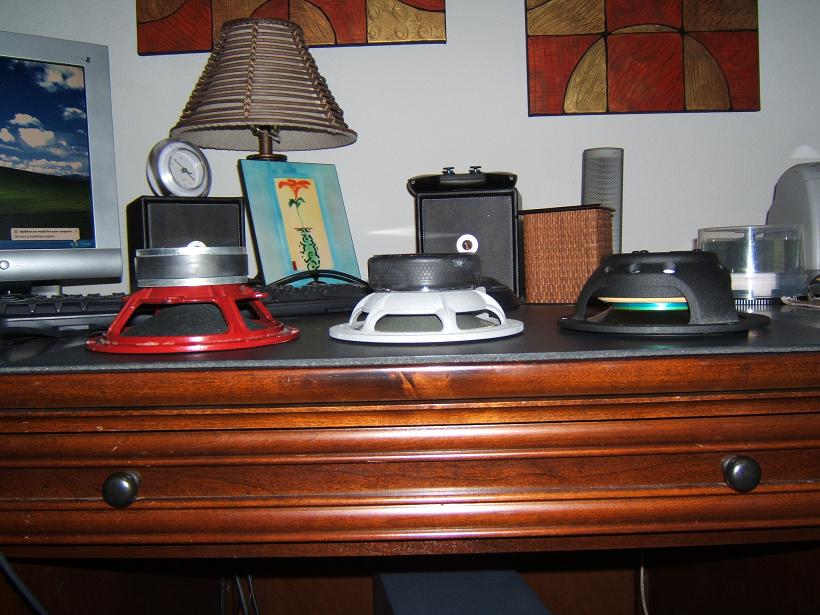

Set a budget. Go with components in the front and either coax, mid-bass, or no speakers in the rear. Biggest issue you will probably face after that is getting your particular front components to fit and figuring out where to mount your tweets. 6.5's may sound like a standard speaker size, but take my word for it there are big differences in dimensions from manufacturer to manufacturer. See the pics attached for instance. Three higher end mids that go for around the same price, but differ in mounting depth by almost 3/4". Also notice how the surrounds, magnets and casing are different.
1" spacers will work for the smaller depth mids, but you will need to go 1.5" or even something more tricky as your depth approaches 3".
Regarding tweets. I recommend kick panels, but many people put them in the stock location. Again, sizing is the only problem. You will have to do some cutting, dremelling regardless of the option you choose. My particular setup has a pair of tweets in the kicks (main tweets) and a second set on the dash (ambient HPF 8k)
Good luck
