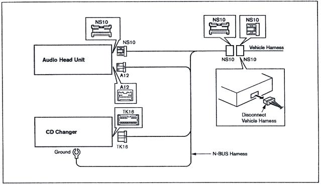

I asked the same question too... Judging from the responses, not too many people know. My guess is it's for some after market wire harnesses....possibly something like what alphared posted.
This is how the cd changer is hooked up....

The diagram I posted above shows you how to add a 6-disc cd changer.
Courtesy Nissan sell a 6 disc cd changer and this is the link on how to install it.
http://www.courtesyparts.com/instruct/350Z-6DSCD_3.html
I guess the two connectors are...
2 wires from illumination control
4 wires for NAVI
