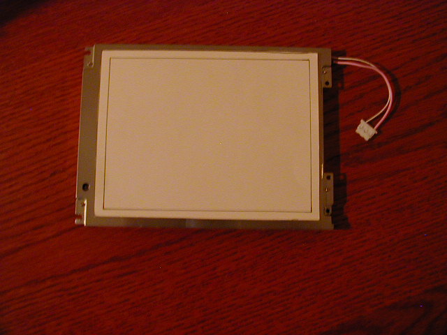

The cappucino computers are nice little boxes, and i've looked at them a few times. But I don't think they are cost effective for a car application. The case is not what we need, it's the components inside the case: a small motherboard, hdd, dvd, power supply. That small case is nifty, but it limits you as to where you can install it, to have access to the various connections located on the sides/front/back.
As for the screen, I am in complete agreement with wanting to go VGA. With VGA, you get the benefit of being able to display VGA formats, but i also do not think you lose anything when displaying NTSC formats. But like the cappucino computer, I think with the xenarc you are paying for things you don't need, in particular, the casing. That is assuming of course thatyou would mount the xenarc in the nav opening. i think you would have to remove the lcd module from the casing, or, do major modifications to the nav area.
A Korean LCD manufacturer is introducing a redesigned 6.4" VGA screen, that should be available in April/May. I just received the specifications on the new screen today. I made a scale paper version of the screen, and took some pictures of it. It has a much smaller case then the previous 6.4" screen, which can also be seen in these pictures.
The new screen will be easier to install then the previous screen, but the active area is the same size. I'm trying to figure out how to install it, keeping any cutting of existing car parts to a minimum, if at all. The active area of the screen is taller then the bucket opening of the nav area, by about .25". I think this is acceptable, and you can just adjust your screen desktop to keep the displayed image within the opening. Width wise, there will be about .25" gap on each side of the lcd module. I think this can be easily filled with 2 strips of brushed aluminum.
Attached Thumbnails Stay away from the mini-itx 2699R case for the M9000...-p1010004.jpg

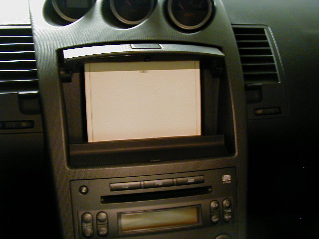

screen installed
Attached Thumbnails Stay away from the mini-itx 2699R case for the M9000...-p1010005.jpg

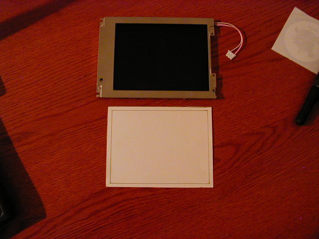

Comparison to previous 6.4" VGA
(Why can't we delete our own posts anymore?)
Oh well....
Attached Thumbnails Stay away from the mini-itx 2699R case for the M9000...-p1010006.jpg

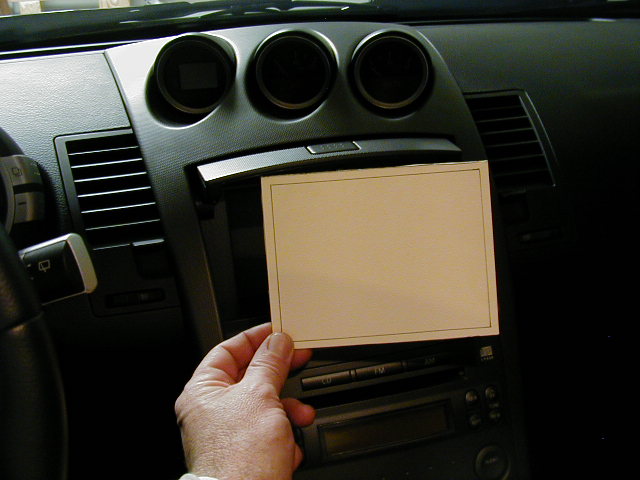

Comparison #2. The size of my paper version is the overall case size of the lcd module. The inside lines are the active area of the screen.
another difference in the new screen is that the mounting holes are located on the sides, whereas the old screen had mounting provisions on front.
Pricing is not available on these screens yet, but I estimate they will be somewhere in the $350 to $450 range, which would include the VGA/NTSC controller, inverter, backlights, and touchscreen. A bit more than a Farenheit, but i think the benefits will offset the cost.
Attached Thumbnails Stay away from the mini-itx 2699R case for the M9000...-p1010007.jpg
