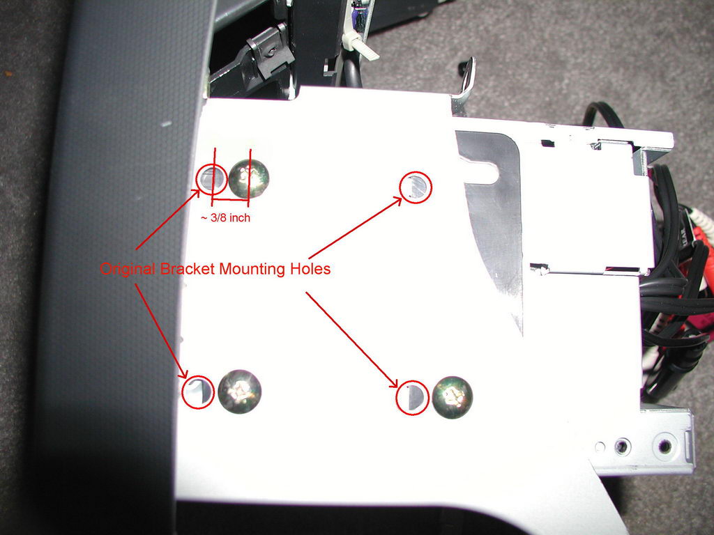

As for the headunit not sitting flush with the trim plate. You will need to drill holes approximately 3/8" behind the original mounting holes. See the pic below:
thanks sooooooooooooo much. Can't believe i didn't think of this before. Damn..damn..

gt3
The new holes you drilled for the flush mount that's 3/8'' behind. What exactly does it creat?
I know that the DDX unit is flat, and our factory bracket is curved. Do you match the top and bottom or the sides?
I mean if you match the sides (head unit's sides flush with car), then the top and bottom will be lower than the car's bracket. If you match the top and bottom, then sides will still be sticking out a bit.
Also, when you say extra dimmer wire on the NAV for the night mode. Do you mean that there should be a wire on the NAV unit? Or extra wire on the DDX 8017?
Thanks for all your help

Originally Posted by SirZaLot
gt3

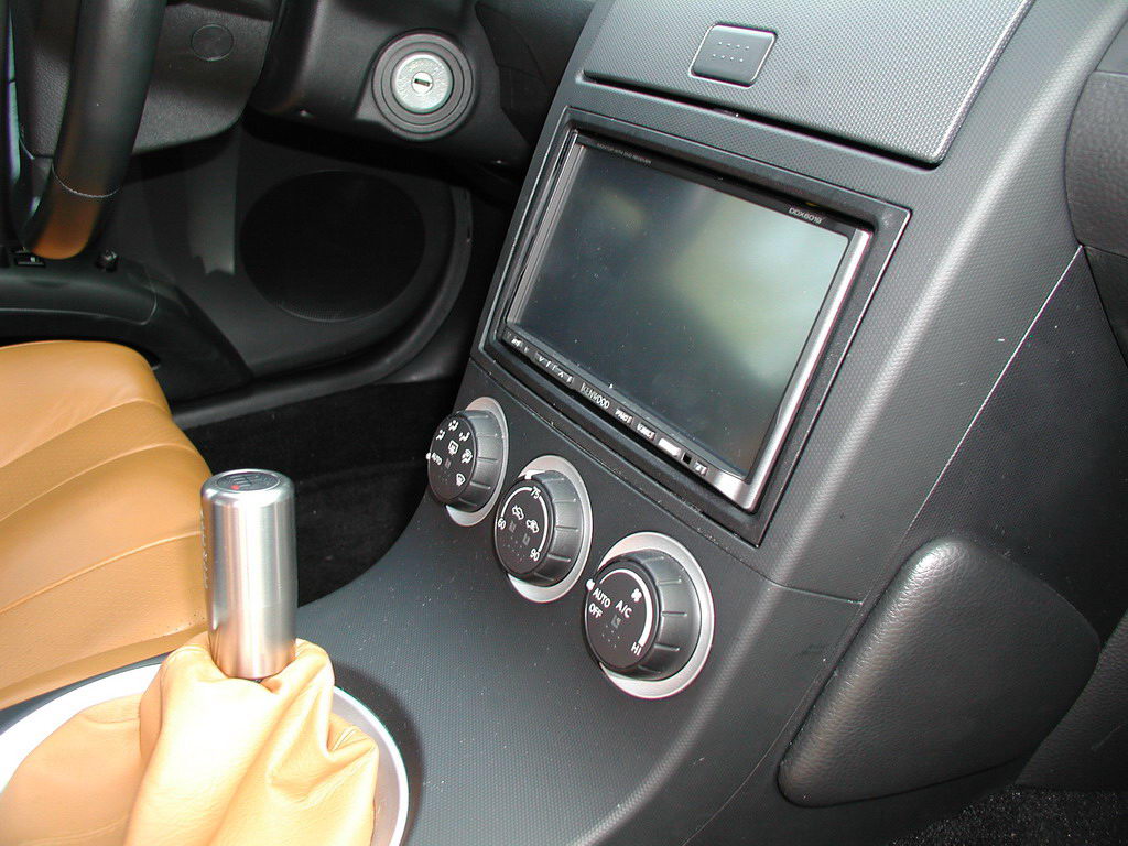

The newly drilled holes in the brackets help to sit the headunit deeper into the console. See the picture below. The face of the headunit is sitting flush with the surrounding trim. I would just measure all the dimensions carefully to get the right position of the new holes.
