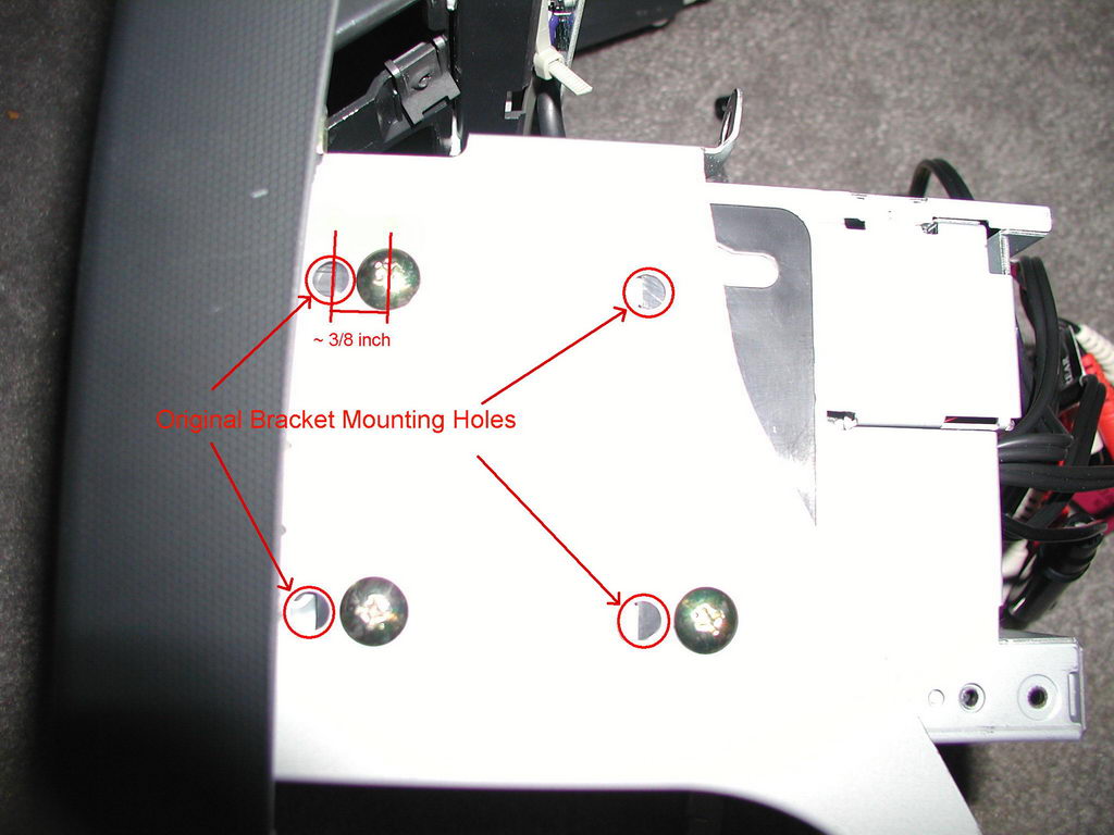

To get my Kenwood DDX-6019 to sit flush with the trim. I drilled holes approximately 3/8" behind the original factory holes on the bracket. I would test fit and measure to ensure the proper distance before you drill. Here is a picture:

Thanks for the picture, since your bracket and my bracket are the same (since they are stock) some additional holes drilled like you have done will sink the radio into the console slightly. Can you post one of the face, more specifically the alignment of the face around the kit.

I did have to remove the factory brackets and re-drill them about 3/8" behind the factory holes. This sunk the Avic Z1 into the dash slightly, allowing the door to swing open.
Good to hear. Please post some pics when you can...
