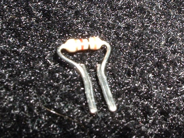

It seems I may have spoke too soon!
On the way home from work the stereo started acting up! The volume would raise then lower. Also, at lower volumes the sound was still heavy on the bass. These effects were so intermittent that it would lead you to believe that some connection was loose.
So, when I got home I checked things out and found the resistor wasn’t secure. I used a new resistor and this time folded the legs in half to give them more thickness before plugging it in. Then secured it down with electrical tape.
I will give you the low down tomorrow to see if it really worked.
BTW, since I have done this procedure a couple of times now, it only takes about 15 to 20 minutes to do. ;-)

Old Feb 11, 2003 | 04:32 PM
onecoolee's Avatar
onecoolee
Posts: 737
Likes: 23
From: PA
Wow, great fold job on that resistor... hehe
Sorry you are the guinea pig for several others, but I am sure a few are following this thread closely...as well as me, b/c I still have my doubts.
I will continue to watch the thread, and I am curious what shakes out tomorrow on your commute.
