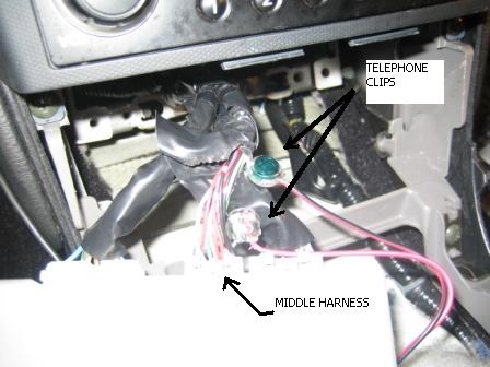

**6. Free up the wire (unwrap some of the black electrical tape like stuff) and cut it. I used telephone wire connectors from radio shack to connect a wire to each of the cut ends. You don't have to strip any wire, just place the 2 ends to be spliced and clamp down on the connecter with a pair of pliers.

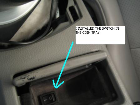

I didnt install the switch yet. I did the mod but just have the switch hanging by my knee. I like the coin tray idea This way I can hide it from the dealer.

yup, i like keeping it tucked away where no one can see. especially the dealer.

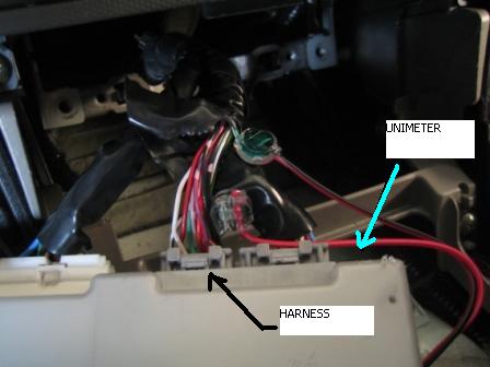

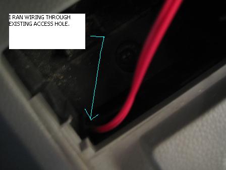

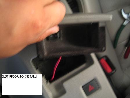

FINALLY! Someone that figured out the CORRECT VSS wire. IT'S NOT THE WHITE ONE. It's the white with GREEN strip like JasonZ-YA says. Everywhere I keep reading that it's the white wire which is WRONG. Anyhow, here is my pics following JasonZ-YA instructions.

sweet! looks good..........so do you have two screens in your car? oem nav and a double din?

Just one screen for now. I'm running an Alpine single din and making use of the lower compartment for my ipod and miscellaneous things.
