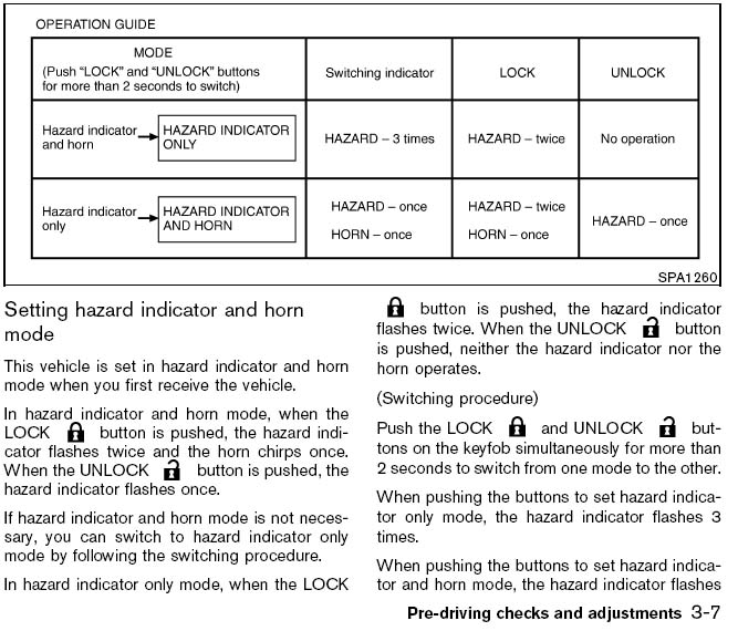

Here is the contents from the manual

No...not when I lock/unlock it. When the alarm goes off/when I hit the panic button the headlights flash.

Ohh...ok. I see what you're saying. My headlights also go off when setting off the alarm, or atleast they're supposed to. I tried it once to make sure it works when attempting to open the door with the window down, and it did. I wasnt able to see if the headlights were going off, but the manual states that they will. I dont know of a way to disable this, but how often is your alarm going off? I'm guessing that if it is legitimetly getting triggered, it is worth the risk of damaging the lights.
