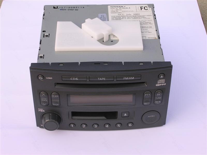

This happened to me & luckily it was insured via USPS to which I got reimbursed for the $300 replacement of the CD player. The CD player has a lock which should be in place during shipment (white plastic on top). With out it the CD mechanism is jarred & easily breaks.
Attached Thumbnails NEED HELP PLEASE !! stock bose problem-dscn0808-medium-.jpg
