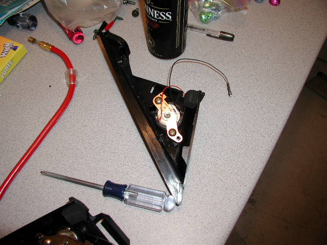

Not sure on the dimensions for the Diamond Audio tweeter, but if they are anywhere near the JL XR tweeter dimension, you may want to try and do what I did.

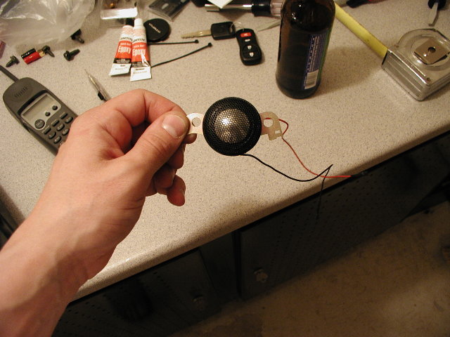

Remove the sail panel, and remove the tweeter assembly from the sail panel. Remove the screw securing the tweeter to the piece of metal. Remove the tweeter from the metal. Determine center of your speaker, line it up with the whole in the metal plate and epoxy the speaker in place.
I have pictures and will post them tonight...

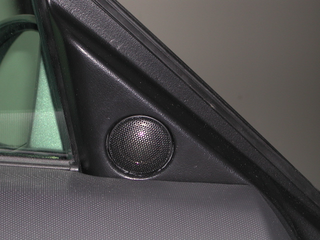

Like I said earlier, not sure about the Diamond Audio tweeter, but here is my JL tweeter install in stock location without any cutting of the sail panel. Maybe this will give you some ideas on how to mount yours. I have some other photos if you want to see them...

Here's another of the tweeter after I epoxy'ed it to the tweeter mounting bracket before I re-attached it back to the sail panel.
edit:
this is the only other picture of the tweeter. But, the finished product looks stock - no drilling required
