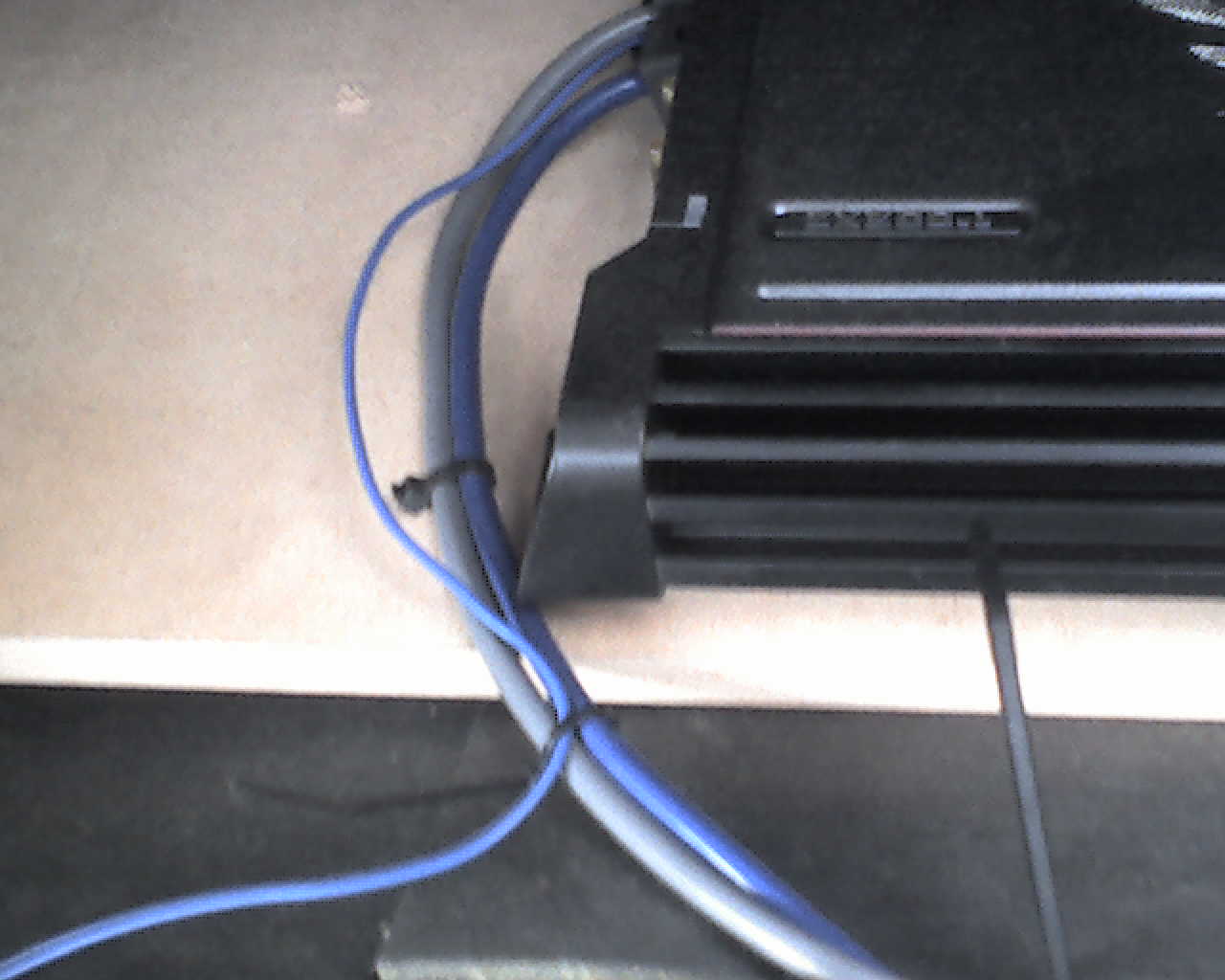

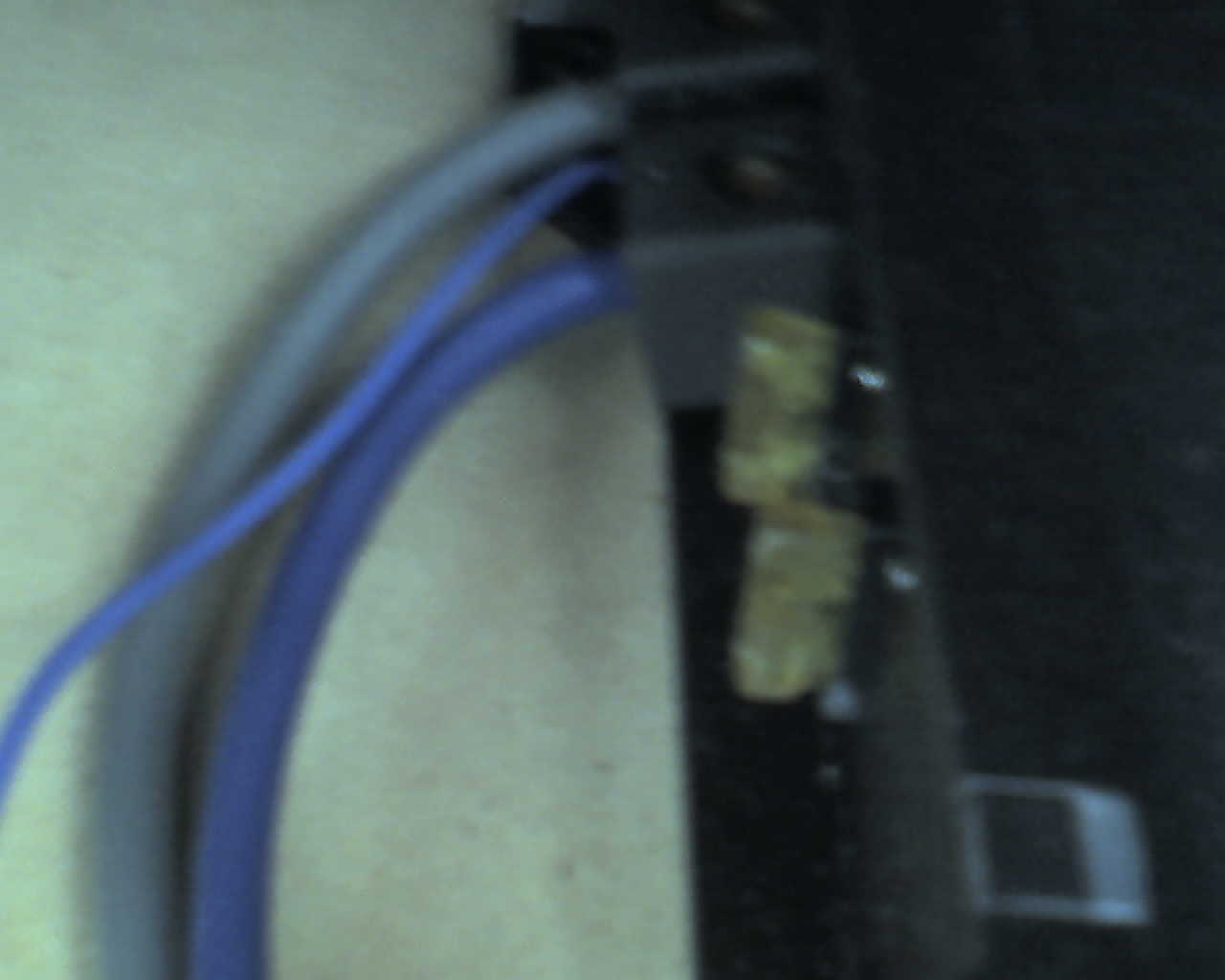

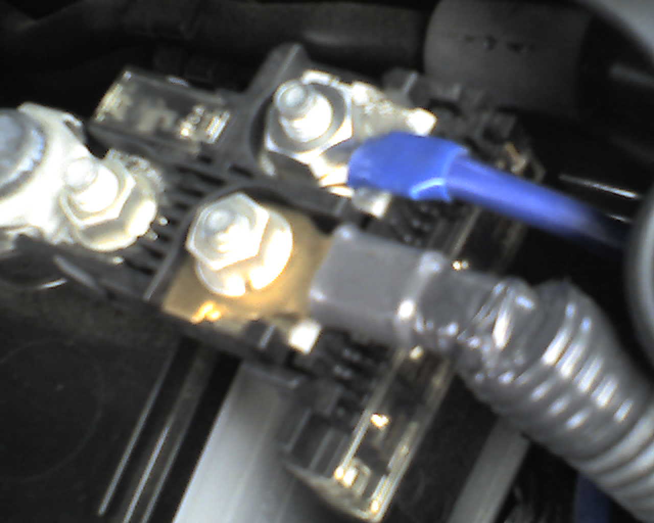

Also, I cant tell what guage the power wire is.. Can you tell from the pics?
Assuming this is 4 awg wire, I need to get a distribution block, and from that I should run 4 awg wire to the sub amp and 8 awg wire to the component amp?
Hard to tell from the pictures but the blue wire doesn't look nearly big enough to be 4 gauge. I would guess 8 gauge. It's printed every 12" along the length typically.
