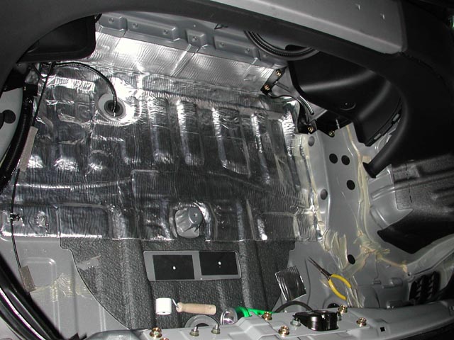

I've been using Fatmat and I think its just as sticky. To make it easy to work. I only put on section at on time. It's not one piece but it shouldn't sound different and it looks fine. Before I put it over bolts I punch a hole with a gsket punch. So everything should come apart if you need to remove anything.
Attached Thumbnails Installing Dynamat....now I know why its sooooo $$$$$$-fatmat.jpg
