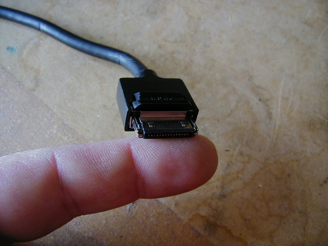

Prior to receiving my screen, I had read a couple posts from others stating how terrible the connector to the back of the LCD screen was, in that it was very difficult for it to make a good connection. I felt very lucky that when I installed my screen (the first time) I didn't have any issues with this connection. The problem I had was at the other end of the cable, where it connects to to the back of the computer, as the slightest touch to the cable here would cause a loss of signal to the screen.
Dave at DS Customs (from whom I purchased the screen) promptly sent me a replacement cable (thanks Dave!). Unfortunately, I have the encountered the connection problem that others have mentioned. There are just too many dang contacts in too small of a connector to try and get all of them to seat correctly.
Currently, the "G" in "RGB" just isn't quite making the connection, which makes my screen appear as if I am looking at it through 'rose colored glasses'.
If there is a bright side to this picture, I guess it is that the other end of the cable seems to be working fine so far. Which hopefully means that I won't have to remove the tunnel cover anytime soon, and I can concentrate on just farting around with the center console cover and the rear of the LCD screen.
The connector which I have grown to hate:

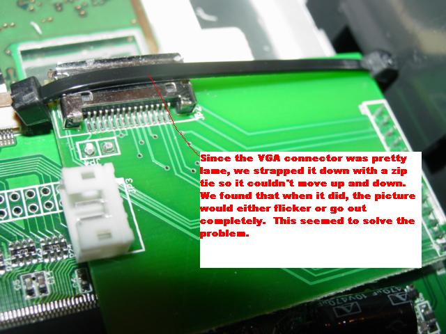

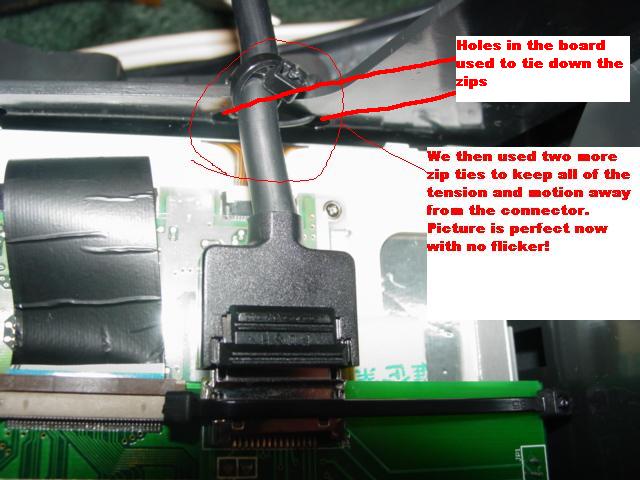

I had the same problem with my video connector. This is what we did and it seems to have solved the problem.
For the full write up with pics on the PC install, go here:
PC Install
PC Install
