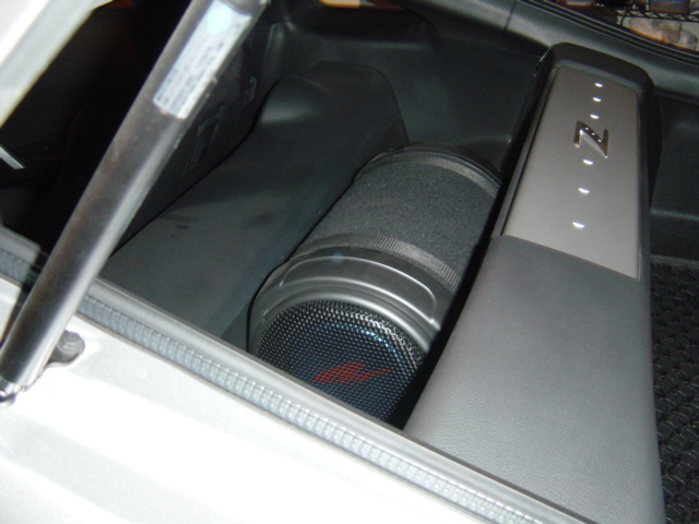

I have replaced all factory "speakers" with Eclipses and added a Kenwood powered sub, but am still not completely happy with the sound. To me it sounds like I am missing something, not sure what. While the bass from the Kenwood sub is tight, it just does not sound like it fits in with the music coming from the speakers. I have tweaked and tweaked but still am only satisfied with certain music.
Here is my question. Is the factory HU the culprit here? The only other thing I have not tried is moving the position of the subwoofer. Would getting a new HU help with the sound? Here are some pics of my sub placement.

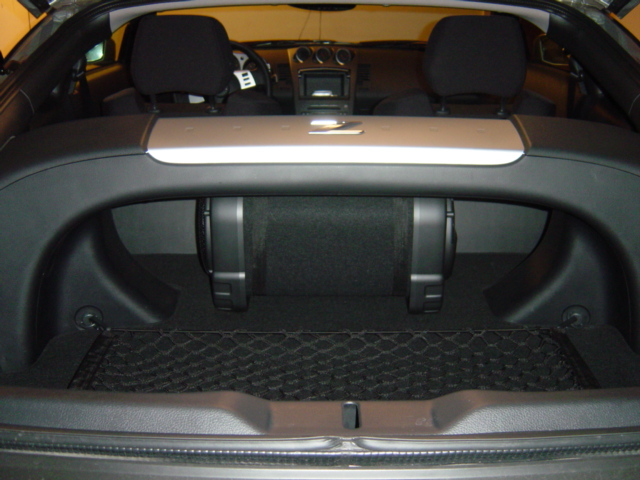

And another

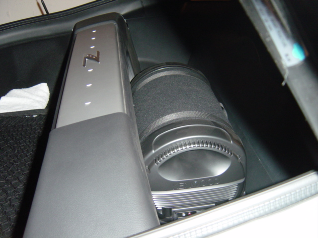

Last one
