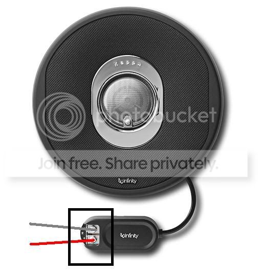

Well I figured since everyone was saying bad wiring it had to be true, I remembered one day when the Best Buy installer was troubleshooting everything he ran into an issue where both rear speaker wires were unplugged from the amp and when he plugged in the left rear speaker wire BOTH REAR SPEAKERS TURNED ON!
Well I figured that had to have something to do with the problem and yesterday I ripped the car apart again to get to the rear speakers and realized that this part of the speaker pod had to be grounding out on the frame of the car
So I taped it all off with electrical tape and the problem appears to have been solved! Time will be the ultimate test. After driving for about a month and a half without audio because of my lack of knowledge and laziness to ask about the issue earlier Im very relieved its over.
